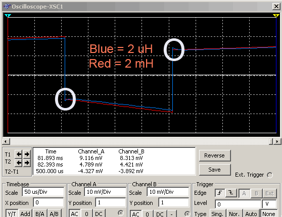

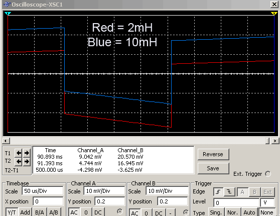

This is an inductor to create a slope in the low pass filter of a PSU, 1% precision is not required. +100% -50% would get us in the ballpark
I simmed it with some better (0.05 ohm Panasonic ECG) transistors. Indeed the 2mH inductor reduces the ringing occasioned by the parallel banks of capacitors -- I would like to try it out in real life...
Thanks for your sims! Yeah, the ringing appears because there is hardly any filtering with the 2uH choke.
How about showing a sim of the rail noise from charge current with a constant draw of 2.6A? - I think that would very relevant in the choke discussion.
For reference you could even show the CRC performance too.
