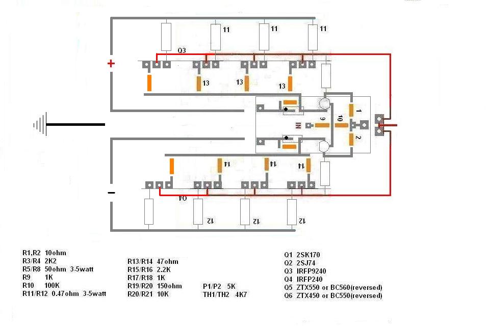

If I manage to do this, I might offer PDs and Cvillers F5 boards fore forum donation

Thank you guys for all of U r help and advise
I want to be clear in one or more fact .
Firs my transformer would give around 36V rail max in class A not 40V or more .
Probably with 2A bias is still will be OK? The main idea to bias the amp into class A mode until the transformer would allow me (1KVA).
I can use 2SK170BL & 2SJ74BL for cascode also if that is OK ! I have nothing against those parts .
You guys right , better to be careful than after to be sorry .
Probably if I do not have the right (clear) picture at the front of me I will create a complete mess and after I would give up as NOT WORKING project.! It happaned with another amp before , I blew up all the amp including some expensive Sanken power transistors . After I gave up .Waste of money and bitter taste .
I do not want to repeat the same mistake again and again just to learn something or almost nothing !
A question if I use 3 pair Toshiba power mosfet do that work with out cascode with 36V rail power ?
The reason I ask these question if I understood well it is easier to drive the Toshiba MOSFET s .
The best way to learn "hands on" that is true , but also true to avoid wasting parts or money to get advise from Experts !
Someone already built the amp with 3 par power mosfet with out cascode but He did it with lower power supp .
Also he use IR type mosfet not Toshiba if I remember well .
Probably I can try if 3 pair Toshiba mosfet work with out cascode ? I'm not into that cascode mode if it would be OK with out .
To hard wire the amp is more difficult to me than to design the layout .
Also I can end up with burned parts using hard wire to .I would like to avoid that.
Greets
Hi gaborbela!
So, you want someone to design for you 100% safe & tested modified F5 with +/-36V rails (1KVA transformer), three pairs of Toshiba MOSFETs in output stage (per channel) and with cascoded input stage (without cascodes 2sj74 will die quickly).
Sorry, it doesn't work that way :no:
It's not a trivial project and you better save your transformer for the time when you acquire necessary knowledge and skills to use it without having a "bitter taste" in the end.
Right now, it would be best to build standard F5 (use Toshiba MOSFETs freely, even two pairs per channel - you can because their capacitance is lower than IR's).
The most important thing is to read and understand F5's service manual completely (I know that soldering iron wielding is far more interesting than reading such a long text, but it will pay off believe me) 😉
