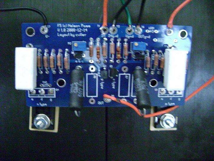

A better picture should be welcome.
Just in case:
The pots are 25 turns. There is to turn several turns before current rises.
IRFP9240 is situated on the positive supply side.
You could unsolder Q5 & Q6 in case they were responsible. The amp works without. (there have been an issue with silkscreen but i do not remember exactly)
Just in case:
toufu said:I built the second channel and still getting the exact same problem, low voltage across R11 and no voltage across R12. I must have connected something wrong. Here is the pic, and thanks for your help.
I would vote for a better picture too...
What is the measured resistance over R3 and R4? Does it change when you turn P1 and P2?
