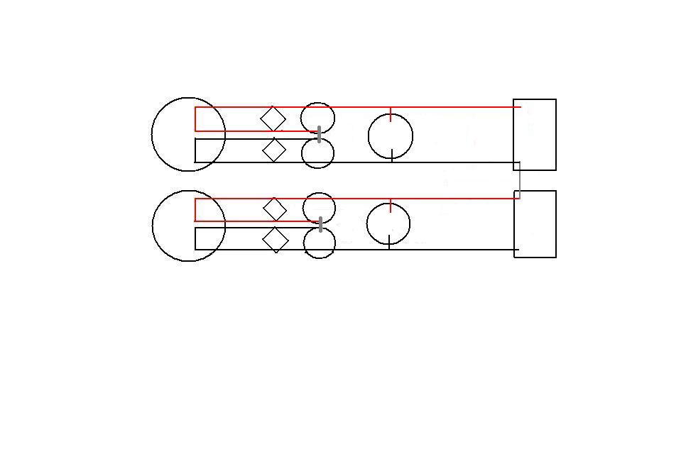

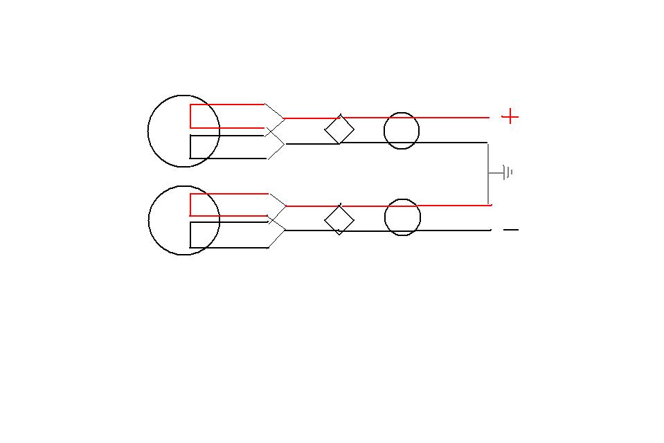

I have four identical transformers- each with dual secondaries with total rating of 160 watts- the ideal at this point was to parallel the secondaries and use each transformer for a single phase with higher VA
so two transformers just create a positive voltage relative to ground and two transformers just creating a negative voltage relative to ground- these used to run 2 sets of amp modules in parallel for a higher powered stereo amp
I hope that is clear for anyone who may wish to throw in their two cents(all donations accepted)

I would make a dual mono configuration with two transformers for each channel. Two secondaries from each transformer paralleled for positive and negative rails. Use two bridges for each channel like in the F5 power supply.
What about dual mono with one transformer per channel.
160VA per channel is adequate.
Or do it like tinitus sketch. Make sure you wire the bridge rectifiers correctly though.

thanh1973 said:What about dual mono with one transformer per channel.
I think he needs to power four channels.
Nelson Pass said:Maybe a bridge for each secondary...
It's gonna look like Paris with all the bridges.
Ahh, ok then
I have misunderstood
I thought it was about a balanced amp, to get more power

I've never done it before. However, logically, it seems like you should use two transformers and two bridges per channel one each for the positive and negative rails. Maybe using two bridges per transformer would be better and have a separate power supply for each of the four channels.
Again, I haven't tried it. When I finally build my F5 boards, I'm probably gonna build the stock circuit and see how it sounds before I start experimenting.

Four channels and four transfos: the best arrangement is one transfo per channel and two bridges per transfo as recommends Nelson.
But 25volts AC are a lot too high except if using a regulation.
Without regulation 25 volts AC will give about 34 volts DC!!!
If you unwind secondaries to get 2x18v AC you will loose Va . You will get about bout 120VA. When voltage decrease the wire must be bigger to preserve VA rating. (less vots = more amps).
The best solution, in my opinion is to sell these transfos or to keep them for another project and to buy two 300VA 2x18volts transfos in order to obtain +/-24 volts DC.
This would bring us to one transfo and two bridges per two channels.
Staking transfos is OK.
...But may be i missed something .
