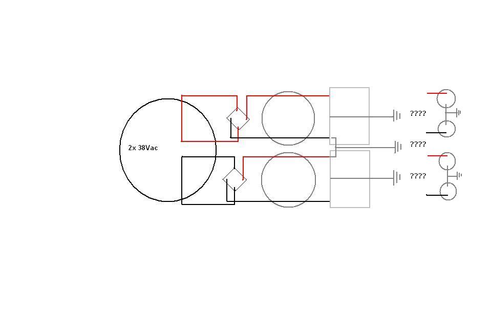

Would this supply work for balanced amp
Cant figure out what happens to grounds
Ok, all I can find is information that a F4 stereo amp can be bridged into a monoamp
I as wondering whether there would be better ways to build supply if only balanced function was wanted
Well, I dont think I will mess with this, and just use my big trafos for ordinary AB :clown:
Ok, thanks
Each board their own respective supply
Ofcourse, I remember it now, true balanced it is🙂
ehhh, maybe its really best when both boards share the same supply, or at least same trafo, and have no issues with any small differences, knowing that balanced could be critical to tolerances :clown:
And the possibility to turn it into a normal stereo could be a nice option too
