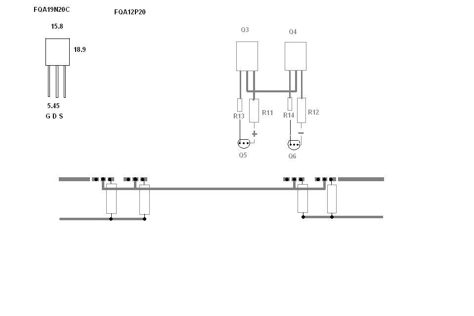

Just started my layout exercise 🙂
Just preliminary to try and get an understanding of what is what
I have a piece of raw board 95x205mm, and cut in two gives me two boards of 45x200mm, and thats what I have to go from
I hope its ok to pop up with this occationally
And would be nice to have errors corrected
