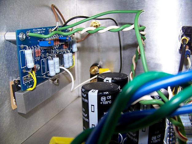

I have the mosfets clamped to the Conrad HS with an aluminum bar. I haven't
yet measured the temp on this bar but it is ripping hot. Heatsink passes the hand test, about six or seven seconds maybe longer, after two hours.
I'm somewhat worried about the fets longevity because of the bars heat.

Just to be clear thats 6 to 7 seconds on the heatsinks. I'm concerned about the bar that clamps the fets to the HS. I can put my finger on it for a second.

Hi,ichiban said:Just to be clear thats 6 to 7 seconds on the heatsinks. I'm concerned about the bar that clamps the fets to the HS. I can put my finger on it for a second.![]()
if the clamping bar is that much hotter than the heatsink then you have a problem.
The clamping bar should be cooler than the device case. I believe that due to the plastic package insulation that the clamping bar should be much cooler than the device case.
There appears to be too much thermal resistance between the device case and the heatsink.
If the thermal resistance is low (correct) then the device case Tc should be within 5 to 10Cdegrees of the heatsink temperature.
What Andrew says makes a lot of sense.
It would be nice if you could measure the temperarure though (possibly with a thermocouple). The bodies response to temperature is not linear. Once you get over 60 degrees celsius the bodies reaction is "this is bloody hot" regardles of whether it is 70 degrees or 100 degrees.
EDIT: I was just having a look at the heatsink surface. It doesn't look to even/smooth from what I can tell in the picture.
Also what are you using between the mosfet and the heatsink?
Is it some sort of tape or silpad?
If the heatsink surface is too rough and the thermal pad too thin then you not going to get good heat transfer.
Ideally you want an ultra smooth and even heatsink surface and a very thin thermal pad, however if the surfaces are rough and uneven a thin thermal pad will not give you good interfacial contact (ie you will have lots of air gaps) and heat transfer will be poor indeed.

The bar clamp could be the problem. Although it looks nice and substantial I bet it's bending at the screw which will keep the fet from sitting flat. Even if it's not visible to the eye, the inside edge of the fet (near the screw) probably has more pressure on it which is causing the outside edge to lift.
It is best to have a screw on both sides of fet for even pressure.

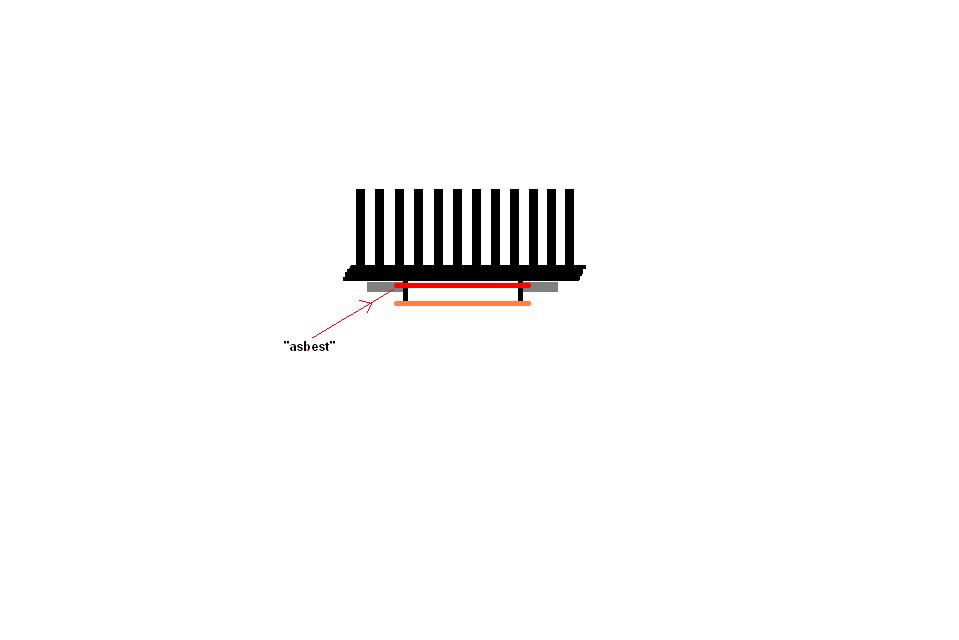

No doubt mounting amp board flat on heatsink is convenient and preferred method
Though I see some heat radiating issues
Significant or not, I have thought of a remedy
Picture shows how I will mount a small sheet of glassfiber "asbest"
Asbest is not used any more, but is mostly made of glassfiber
I have some with alu foil on one side
Glasssfiber is known to cunduct statical electricity, but amp board is glassfiber as well, so I guess its of little concern, but not sure as we are dealing with mosfets, sensitive to that
But once mosfets are soldered I suppose its not an issue
Anyway, this is how it looks
