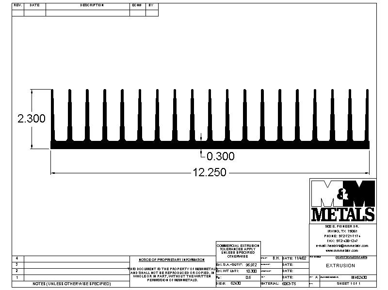

Its hard to find chassis's and heat sinks. I'm looking for something like this.
hi all
i,ve got 8x boards on the way and would like to build 2x bridged ballanced amps
i,m having a problem working out the original parts used for the f5 design becouse everyone seems to be modifying the circuit or substituting parts.
is there a list some where with all the parts i need ,i,d like to build it using only the parts mr pass has used with no mods or part substitutions so i know exactly what i will get ,
i,ve found a link to a store that supply,s f3,f4,f5 components kits but they will only supply a maximum of 1x stereo kit ? and i need 4
thanks in advance for any help
regards sheafer
Re: Re: balanced setup.
Tea-Bag said:
Yes, can do balanced, take input from one board to XLR 2, one to XLR 3, XLR 1 to common ground. Wire speaker to both positive outputs, or just hook up the outputs + to pair of speaker terminals. This gives you one channel. repeat same for next.
tms0425 said:
I suppose this should work, but has anyone actually tried it? It's just ciurious why Nelson didn't put an XLR and mention of balanced setup in the commercial FW F5 as he did on the F4. My F5 doesn't even have an XLR installed (yet).
Got around to soldering XLR in there, ran a wire to the inputs of both boards, wired 1 to ground, and put a speaker on the POSITIVE OUTPUTS. Jumpered since my balanced pre is not quite road ready. Plays music fine. This has been discussed as do-able earlier. Just confirming for the doubting.
