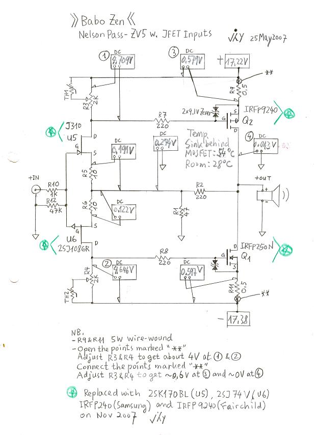

F5 power amplifier
I know it is the best if everything is matching.
Nevertheless, once I have made like this :bigeyes:
That's the reason why I have called this "Babo [dumber] Zen" :clown:
But, the sound is great :bigeyes:
labjr said:
I wonder if you can null out any problems due to mismatching by tweaking resistors etc. ? Or does it even matter?
You can affect the measured performance by tweaking the 10R and 0.47R resistor values -- but you'd better have a darned good THD% analyzer, and a lot of time and patience.
As I have said before, out of the box, with no tweaking of values the THD% of the amplifier is very low. I matched the 10R resistors with my HP3456A DVM -- matched to within 0.01 ohm -- this did not affect the performance. What I did to optimize values was build a board in which I could parallel in values of R until the THD% was at a minimum.
every time you change one of these values you have to rebias the amplifier and let it come up to a steady temperature.
early in this thread I mentioned that there is an annoying HF peak -- it's just below the a.m. broadcast band so you won't see it on a sound-card analyzer -- this can be nulled out by using separate gate resistors for the JFETs.
you could probably tweak the values of the gate-stoppers 47R -- if you wanted to use the amplifier at RF.
If I may ask
what jfets do you use?? With the Toshiba 2SJ74BL and 2SK170BL I use, P2P hardwired, my F5 is the most lineair and cleanest amp I ever made 🙂 -3dB@ 640kHz
No need for corrections....
I am going to guess that the difference is attributable to the Fairchild output devices vis a vis the IRF/Vishay devices. My amp also slews a bit faster than the one described in the AX article.
My curiosity was aroused by an application note I saw which indicated that trimming the resistors around a symmetrical pair of MOSFETs could "even them up".
The JFETs I use are Toshiba 2SJ74BL and 2SK170BL -- these were purchased from Newark a couple years ago, while you could stilll get them in quantity.
I can only tell you what I observed. I looked at it with an HP 3577 network analyzer...could also be the little bit of inductance in R11,R12. I've used some Ohmites which are for switching power supplies, I've also looked at Holco, Mills, Dales but the Ohmites (for the price) get the heat off the board.
