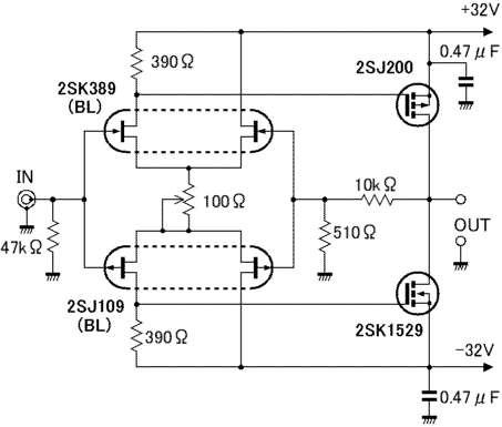

Any reason why Mosfets instead of Jets...?
Can't press down the Vds of Jfets in this case...?

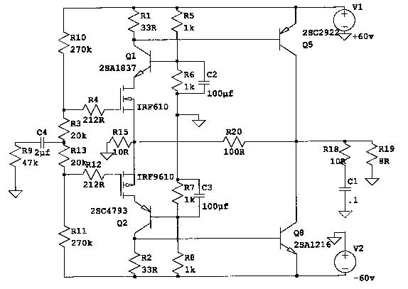

Oh no! You've added caps. 🙂
Seriously, I wonder what difference in performance one
might expect if IRF610/9610s were used instead of
those cute little jfets.

I would suspect you'd get similar differences that you see between the Aleph 30 and the Aleph J.
Only 1 'real' way to find out eh Dennis

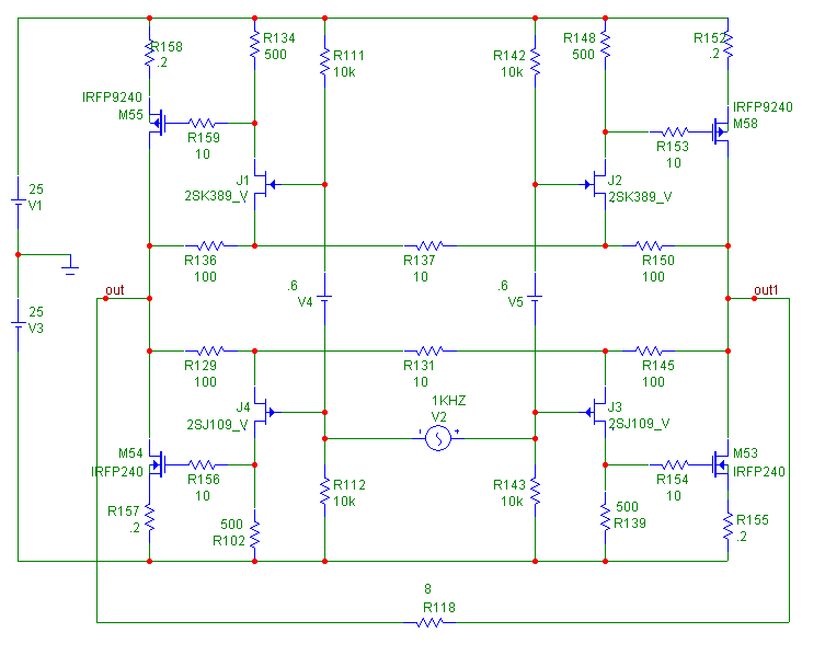

Thank you for your help Nelson.
I have looked at my circuit for a while and I guess the reason for my confusion is, because I didn't have an IRFP240/9240 in my library of components, I used an IFR540/9540 instead which initially looks like it has similar specs but of course it doesn't.
I eventually imported a IRFP240 into my schematic and changed the biasing to match.
I hope this new version is better.
Cheers
Tim

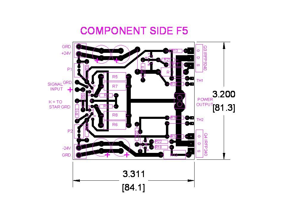

Here is one way we could lay a one sided board for the F5 circuit based directly on Nelson’s schematic.
Still on the proofing stage so suggestions, discussion and corrections are welcomed.

Nelson, thanks for sharing this wonderful amp that I’m sure will transcend time and be regarded as a classic. 😎

Your PCB look nice!
I just have one comment. These 2 FETs will run so hot, can you increase the distance of them to around 6 inches.

Zayan said:... will run so hot, can you increase the distance of them to around 6 inches.
Yeah...
I often wonder why many of diyers here are not using the chassis space (or wide heat sink area) efficiently for better heat distribution. In general, they are eager to make the signal path as short as possible, and crowded layout with the components... But, at the cost of probable short FET-life, for what...? Better sound? Beauty? Anyone can explain?
Babowana said:
Yeah...
Could it be driven by the standard sizes economically available from the manufacturers of short run pcb's?
Compare the F4 board from PD with original layout per NP for instance.

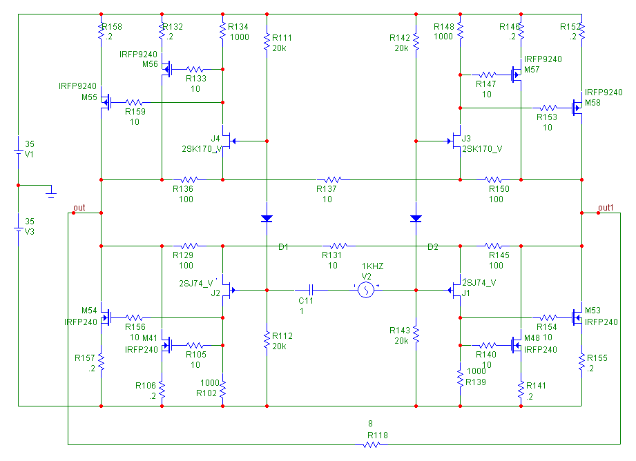

TimS said:How about scaling the balanced design for more power.![]()
Please remember that the JFETs you are considering to use
have maximum Vgds of 25V...
