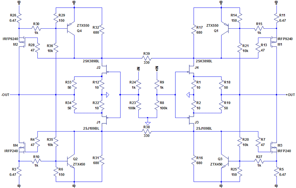

In search for the x-ed f5 .... ?
http://www.diyaudio.com/forums/showthread.php?postid=1485083#post1485083
"The only remaning question for me is :
If I wish to go balanced, should I just use two of these or should I use complementary diff pairs for the first stage and Xed feedback ?"
http://www.diyaudio.com/forums/showthread.php?postid=1485298#post1485298
"4) The question of using dual diff pairs is moot, as you will need 2 pair of JFETs in either case. The effort required to run the feedback back to the Gates versus the Sources is not much, so you can explore this without much effort."
http://www.diyaudio.com/forums/showthread.php?postid=1486951#post1486951
"anyway - I can't see easy X-ing that circuit , without resorting to good ole "out to gate " feedback scheme , and that way we are loosing virtues of low impedance feedback path ......... "
All the answers were there, IMHO !!

EUVL said:
> Here's a conceptual PCB design
IMHO :
1) I would use a foil resistor at the MOSFET source (R11), like e.g. MPC74 0R47, which has a similar footprint as wire wound ceramic resistors.
2) I would place TH1 directly on the MOSFETs for thermal compensation.
3) I would place R13 as close to the MOSFET gate as possible.
4) I would place R3, P1, R15 as close to R13 & R11 as possible.
5) R19, R17, R21 and the BJT can be placed further away, as they are only for protection.
In addition, the feedback path also want to be as short as possible, without saying.
Patrick
1) I'll try it with both a metal foil ceramic and WW --
2) The thermistor can be mounted on the device or on the HS.
3) R13/14 are a few mm from the gates
4) As R11 heats, the resistance of R3 and P1 (etc.) will increase -- wouldn't you want R3/P1 R4/P2 further away from R11/12?
What would you suggest as a temperature coefficient for the thermistor?
When I get the boards wired up I will run them on my spec analyzer out to a few MHz -- as the gate stoppers are purposefully low...
For myself, I almost always use TO220 or TO247 (e.g. Caddock) power resistors for source degeneration. Which means I just mount them on the heatsink next to the FETs, and hard wire from source to resistor. As such, components on the PCB do not see any of the major heat dissipating elements directly.
But then some of you might want something less expensive. So that was why I gave you another tipp to use MPC71 or MPC74 :
http://www.nova-elektronik.de/english/resistors/mpc.php
http://www.buerklin.com/
If you mount them on the PCB, such that the ceramic body is say 4mm above PCB (either with a knick in the leads, or a ceramic standoff), 1/4W resistors lying flat on the PCB will also see very little of that heat. In a Class A amp, everything sees the heatsink temperature (say 55 degC) eventually. So I would say your worry is undue.
Tempco of the NTC depends on the tempco of the FETs, which is different from FET to FET. For IR FETs, you'll have to ask Nelson.
For R1 & R2, you can always parallel 2x or 3x 2W resistors to reduce the tolerance and inductance.
