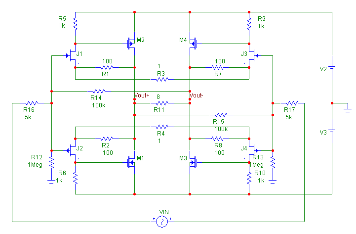

Balanced F5
I have simulated my previous balanced F5 and i got it to work after tweaking a few resistor values and reorienting some output devices (after my stupid mistake in the previous version of this schematic).

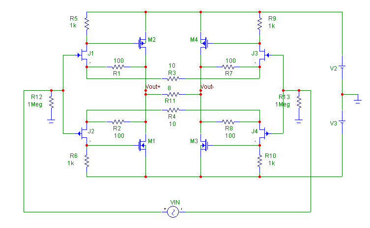

Re: Balanced F5
Ignore this schematic I resent the previous schematic by mistake.
I have attached the correct one.
Cheers
Tim
Papa was quicker, doh.
It won't work like this, biasing is via the 100R's, not the 10R's.
And to get the same voltage swing accross the load as with the straight and simple bridge, R4/R5 would be like 4 Ohms or so (and the other 4 all 10 Ohms). According to my quick sim, it gives x10 the distortion...
- Klaus

In reply How it currently works:
J1 is biased through R1. The offset that would be caused at Vout+ is cancelled by the equal current drawn by J2 and R2.
According to the simulation at 0V in J1 and J2 both draw about 3mA, this would in turn generate a 3V drop across R5, which in my simulation is enough to bias M2 to about 1A.
I think I see the Biasing error that Nelson is referring too, I should have source resistors on my mosfets to help stabilise the bias currents.
One of the nice advantages to this approach is that it has a common mode gain of 1 but a differential mode gain of (R1+R7)/R3
