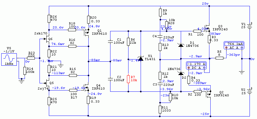

If we use F5 as a preamp and we loose input buffer from F4 and put them together we might get one serious SuperF amp. My next project:

This is what I was proposing as a higher powered version of the A5...............of course Mr.Pass's more sophiscated biasing and feedback network could be and (should ) be used.

jam said:
Juma
You could get rid of the capacitors C1 and C2 by hooking the bias network between Q1 and Q6 . You might also loose some voltage swing if the front end is not driven with higher rails.
Jam
I'm not a cap fetishist 😉 This is a low Z (high currents) environment and the influence of the caps is really negligible.
The circuit as it is shown in post #267 can easily swing 22 V which is more than I need. Of course, there are component's values that need tweaking - more about that when it comes to actual building of the amp.
