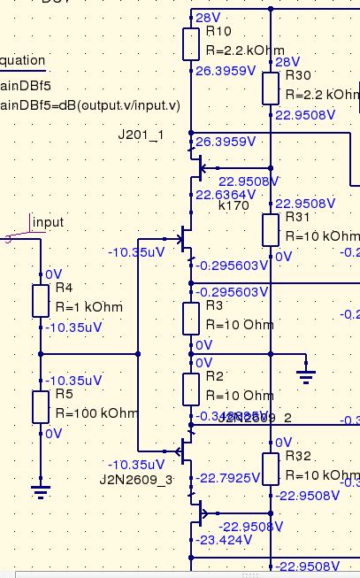

another mod
Ok, in my construction I have to 21 AC toroids providing ~28 volt dc. Because of the 25 volt rating of the 2sj74 which I use for input jfets i cascoded them both (2sk170 and 2sj74) with other two matched jfets. The voltage divider for the input of cascoded jfets is 2.2k/10k. Doing this the input jfets are working at around 22 volt so we are OK. Do you think that is better to remove the cascade, is the 28 volts dangerous for the input jfets? By cascoding this way do you thing I am doing anything wrong to the perfomance of F5. In sound I didn't noticed anything different.
The attached image is showing the case.
Any thoughts are welcome.
Re: another mod
cascode them to 10 to 13V
Thanks, I would like also to see any opinion of Mr Pass, concerning this dilemma i am facing. Should I cascode jfets or 28 volts willl not damage jfets and performance? If I cascade (like the previously attached schematic) what voltage is the optimum? I'll wait a little bit cause I am really confused.

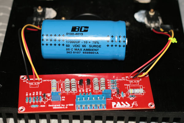

Both amps initially seem to be working but there is a difference in temp of around 20C between the amps.
The amp that originally had its input JFETs blown (now replaced) stays at around 30C, whilst the one that was working from the start is around 50C. Both amps have the same heatsink and the bias voltage is set the same.
Would I be best changing the MOSFETs of the one that blew the JFETS or any other ideas?
Thanks once again!
Thermos
I believe I worked out the problem (I think!) - the amp that was getting hot, when I measured the resistance across R10 (100K) it was only 7.5K Ohms.
When I replaced the JFETS , the resistance across R10 returned to 100K.
Originally I had all JFETS with 7.0 in both amps, now that I have replaced them on the faulty amp with a set that is 8.4, is that likely to make a difference?
