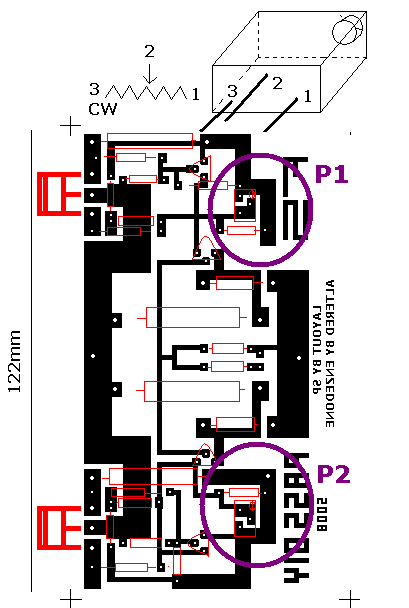

Re: Stupid Question
Hey Enzedone, lighten up, everybody seems to be in his own wave here, sometimes this happens.
Your tracks for the trimpots looks OK to me.
enzedone said:Is the track layout correct for P1 & P2?

Stupid Question - P1 & P2 Adjustment
Before I switch it on.....
I am reading the F5 manual, under "Initial Adjustment".
"you will want to set the values of P1 and P2 to their minimum. Verify this with an ohmmeter"
Just to clarify, does this mean I want to initially set P1 & P2 to be 0 Ohms (or the lowest it will go)?

Re: Stupid Question - P1 & P2 Adjustment
Yup! zero ohms. Be sure to consider the output DC zero as the most relevant, and measure the volts across the resistors at output devices , the voltage at the input will not affect the final results. Not really important, it's important to get zero DC volts at the speaker output.
According to my approximation, we will have final values of P1 and P2 at about 1K+something. So, I highly recommend you to start P1 and P2 values lower than 1K.
Be careful, if you have too high P1 and P2 values, the bias current easily goes up more than 10A . . . No good, even if the amp has the current limiter at 10A . . .
