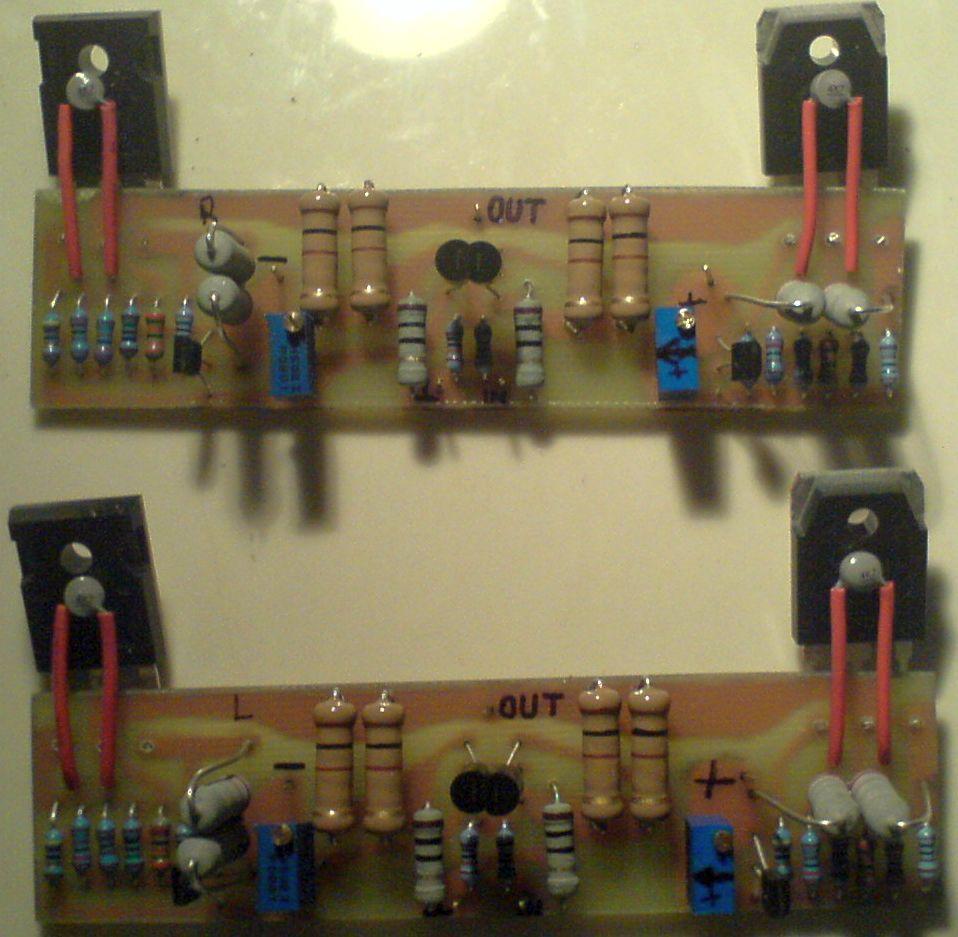

Ref. post #1969
There has been some progress; new PCBs are completed and tested with clips on large heatsink and +/- 17.5 V PSU (1.3 A bias). After an hour of listening I couldn't spot a difference compared to standard F5 - although there are some minor component changes:
1. MOSFETs' source resistors were two 1R in parallel, now it's two 0R22 in series
2. 10K resistors in the current limiter circuit are changed to 22k as Mr. Pass recomended
I'll report again after I mount it properly in the case and after some friends lend me their ears (and some of their gear) in listening session to help evaluate further.

gerbers?

Nicely done!!! could you post this as a gerber file or a .pcb, or .dxf or other file type that could be imported into a gerber viewer or layout editor? The .gif format comes out a bit fuzzy.

Hi increek22,
I use Sprint Layout for PCB drawing and in version I have gerber export is not working, so I attach a ziped high res. .JPG (2100 x 500 px) which I hope won't come out fuzzy.
It's a bottom view pic, PCB dimensions are 105 x 25 mm - component placement is self-explanatory for such a simple circuit. Good luck !

Thank you Jumo.
If any interest, I posted a layout for the B1 buffer under the B1 Buffer Preamp posts. It is also for single- sided PCB. I drew it in "PCB Artist" which is a free download. So anyone can download PCB Artist or other gerber tool and printed on transparancy for photo sensitive boards, or to a laser printer on toner-transfer film. I have had good luck with the transfer films and etching at home.
Next project is an F5. Thanks to all for this great forum!
