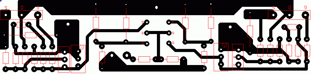

I'm not too good with this sort of thing. So I would really appreciate it if someone more knowledgeable than me could have a look at this.
It's not perfect but the scale is right for the parts I have.
Please excuse the dodgy parts lay-over, but this was drawn up with windows 'paint' so all those white bits where the component names are won't actually to be kept.
This circuit was originally laid out by 'SP'

I'm doing it right now - recycling the old Mini-Aleph. Rails are +/- 17V with 1.3 A bias. Transformer is exactly like yours - 2x15 VAC/300 VA followed by two bridges (made of MUR840 diodes) and CRC filter with 80.000 uF per rail. The amp and PSU are behaving very well. It's not finished because I need to make another PCB layout (it's case and heatsink dependent). I tested with p2p made circuit and my main object was the PSU's adequacy. When I complete this Mini-F5 I'll be able to tell you more - a real comparison with standard F5.
The new PCB (105 x 25 mm) should look something like this (bottom view; thanks Goffe 😉 ):
