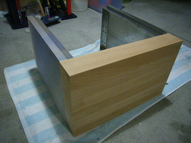

finished H/S for F5
Well they are almost finished. The sides need straightening up where they will butt up against the front plate/slab.
They measure 270mm High x 380mm Deep x 25mm thick, if you look at this pic.
The front plate is 430mm Wide x 270mm High x 60mm Thick
I'm actually worried that the heat will peel the varnish off the wood.

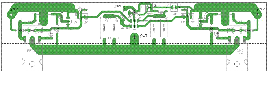

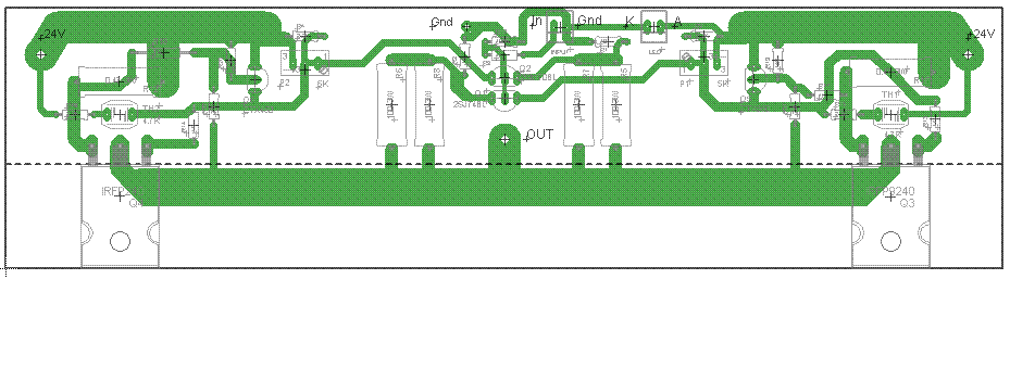

I just made the F5 this weekend and I must say I'm very impressed. After having done a detour of Aleph J and a gainclone (kinda of a must for diy people to try out), I had a Saturday alone (no distractions), so I drew, etched and populated my new F5. Yesterday I fired it up, adjusted and listened. Great amp! Thanks NP.
:worship:
One thing I noticed right away was the clarity in high frequencies and the detail of instruments.
My pcb is single sided and I didn't care too much about wire placement, but assembly was easy anyways. If anyone wants a bw version just drop me an email. The board is 105x50mm and the distance between power fets holes is 80mm.
