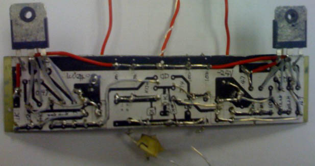

Sounds like you have a short or have connected your power fets wrongly (if connected wrong, they are just power diodes). Try monitoring the voltage across the source power resistors (r11 and r12) when you turn up the voltage slowly. Otherwise post some detailed pictures and people in here might be able to help you.

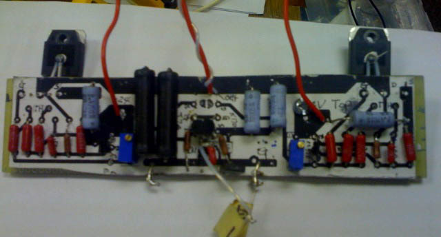

The apparent resistance accross + - 24 / 0 is about 40-50Ohm for both channels, so I don't know whether a short would be. The voltage across R11 and 12 is 0 for both channel, but for left channel the current through +24 -24 is 0 and for right channel the current reaches 1.5A at when rail voltage is as low as + - 2 V.
Attached is picture of a mian board. I printed PCB layout on paper, pasted it on perforated board, and followed traces. I checked a couple times with oringinal schematics and can't find what is wrong.....
I'd appreciate any help!

RDK845: I'm sure you can already see this question coming but are you sure the back traces are not touching the heatsink?
Re: Re: Re: firing up but fuse blowing
Yea. I have stand offs between heat sinks and boards. Measurs discontinuisty, when I disconnect the current limiter between PSU ground and chassis.

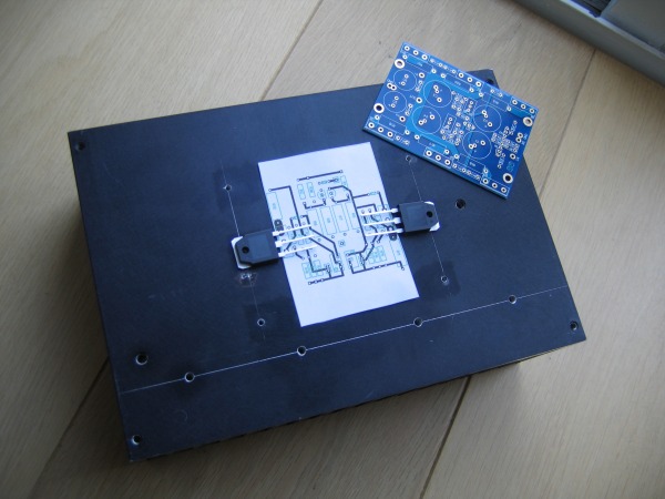

and an other f5 pcb design 🙂
Hello everyone,
Past few days i've been buzzy designing my own F5 PCB. Quite interesting because its the first time i really tried. I used DipTrace.
I'm wondering if anybody is willing to take a look at it. My main goal is it to make it the same size as Peter's F4 PCB's and locate the FETs on the same position so i can easily fit it in a F4 chassis.
few notes/questions:
- i intend to use cadock resistors in he signal path
- i want to have PCB's professionally made, that's why i used two layers (any suggestions where i can have a few samples made without paying the jackpot...)
- small traces are 1mm thick traces are 4mm. is this enough?
- does anybody know where i can get get those nice blue Panasonic .47r and 100r 3watt resistors in europe.. or does anyone have some spares i could buy?
thanks in advance!!
cheers,
c.

The apparent resistance accross + - 24 / 0 is about 40-50Ohm for both channels, so I don't know whether a short would be. The voltage across R11 and 12 is 0 for both channel, but for left channel the current through +24 -24 is 0 and for right channel the current reaches 1.5A at when rail voltage is as low as + - 2 V. Attached is picture of a mian board. I printed PCB layout on paper, pasted it on perforated board, and followed traces. I checked a couple times with oringinal schematics and can't find what is wrong.....
Your right channel appears to be shorted... try focusing on only one channel at a time - disconnect the right channel. Are you sure you haven't mirrored one of the channels?
Re: and an other f5 pcb design 🙂
culture said:
Hello everyone,
thanks in advance!!
cheers,
c.
Hi culture. Send me a pm, I have some .47 3W blue Panasonic for you (and I can do something for the 100)
cviller said:
You are ok as well, but if you I have seen most people flip peter daniels boards the other way around. 😀
stupid people :angel:
Thanks massimo, PM send!
i have decided i'm changing the the footprints of the ztx trannies, this footprint is asking for problems with my shaky hands
cheers,
c.
cviller said:
You should also consider making the holes for wire connections bigger, unless you have some fancy connectors.
Regarding the prototyping, you can try www.olimex.com/pcb/
Hi cviller,
Well, those holes are definitely a thing that need my attention, i also want to get rid off the square holes.
square holes, round holes, through holes, inner diameter, outer diameter.....this pcb designing thing is one big new adventure to me 😉
cheers,
c.
Re: Re: Re: Re: firing up but fuse blowing
I have disconnected the left channel from PSU and taken out the right channel board from heat sink. It seems short on right channel is gone but now there is no current going through the board from + and - 24 rail. 10mA at 20V. there is no voltage across R11 and 12 regardless of P1 and P2 value. I replaced JFETs but the same results. Should I replace the Mosfets also? Except the bias voltage across R11 and R12, which voltage can I measure to see what's going on...
The left and right channels boards are identical looking from top.
Thanks for your help!
