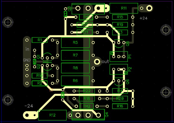

almost finished 🙂
checked all traces, changed some footprints and traces, added mounting holes...
comments are still welcome!
cheers
c.
You are ok as well, but if you I have seen most people flip peter daniels boards the other way around.
It almost doesn't matter how you orient Peter's boards for the F4 as the outputs are so gobbed together.
But for the F5 with only two MOSFETS, one on each side probably IS pretty optimal...
I'm thinking I could make one of my Burning Amp cases into a four channel F4 to use balanced for two channels, then convert my current F4 towers into the F5's with cultures' boards that would just bolt on.
Good marketing feature culture! And the board looks lovely to me, but I haven't traced it out. I'd order a pair if they were made available..

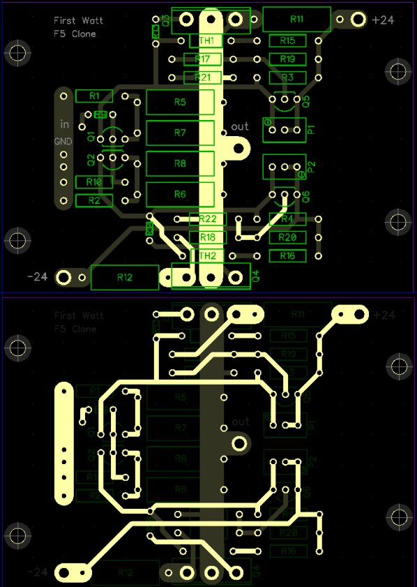

Hi Variac
Since ordering 10 sets is as expansive as 2 sets i think it should be possible to make a few sets available.... it might take a while before they are finished because this PCB designing thing is a new adventure to me. Still have to figure out if i didn't make stupid mistakes (non existing hole sizes or what ever) and where to order (looking at pcbcart.com at the moment) what specs the boards should have (thickness, surface finish...).
And one more thing, i'll be going on an other new adventure tomorrow.. riding waves in Morocco 😉 never done that before 🙄
btw, this is what the pcb looks like right now, moved most traces to the bottom and a few other minor changes
labjr said:
Culture, I still feel the outputs should be farther apart for better heat dissipation as you can see on the original F5.
Hi labjr,
My guess is that if six fets in an F4 on the same size board works fine this shouldn't be a problem either, i could be wrong though...
In post #2136 you can see a picture of the sinks i use and i think the fet placement isn't that bad this way. I also have a few heatsinks witch are more stretched out, i might use a few extension wires to place them further apart (if i decide to build an other F5).
cheers,
c.
