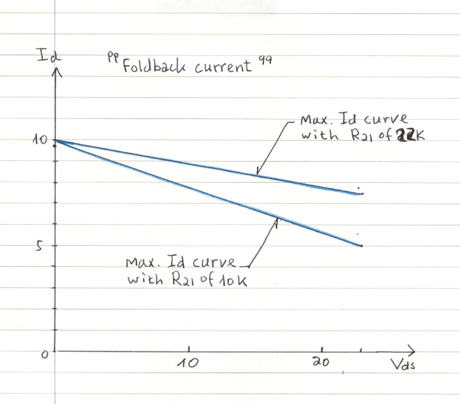

I hardly see such catastrophic risk. The amp limits the peak current at 10A. In addition, it has the "foldback" function in case that the voltage is high between the rail and the middle point.
I admit that I do not understand this "foldback" function and I would not mind an explanation - thank you 🙂 My concern is that my speakers would not survive too many volts DC at the output and replacing even a single driver unit - most likely the mid-range driver - would be VERY expensive. With a F4 that has 3 FETs in parallel I would feel comfortable even without DC protection, but with just one FET I would not ...
The power dissipation of the output mosfet could be expressed as W=IV, where I= current through the mosfet and V= voltage across the mosfet. When the mosfet sees maximum current (limited to 10A) and the maximum voltage (abt. 20V/output short/just in case) at the same time, the power dissipation will reach to the maximum, which might cause a damage of the mosfet. To avoid this situation, when the mosfet sees the maximum voltage, the "foldback" current system reduces the current flowing through it, and reduces the power dissipation.
I understand that the "foldback" is provided to protect the output mosfets. If there is no problem with the output mosfets, the amp would work normal without giving users any problem.

Babo's story is half right, R21/R22 will trigger the BJT's at a lower Vds level.
Take 9A output current in a continuous 1.5 Ohm load, for example.

Here is my estimation of the foldback current. The maximum Id values are reverse proposional to the Vds values. Of course, the foldback happens at any Vds. I do not know whether I'm right with my estimation. I am just doing my best
