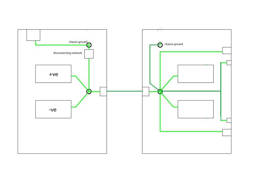

Thanks, I knocked up a couple of diagrams to try and show the schemes i'm working on.
The first is fairly standard with audio grounds tied in he amp and the power supply grounds tied in the power supply. These are then connected through the power cable. The chassis grounds are connected through an external banana plug so that they are both 'behind' the disconnecting network.
EDIT: Deleted second image due to it being completely wrong!

The power supply is the place for your "Star Earth" and is okay, but the second star earth in the amp case combines all the speaker return currents with the amp 0volt reference points plus adding noise to the input shields - this (IMO!) is where it's better to run them seperately back to the p/ supply star earth [the chassis earth is okay].
Mind you, many amps do exactly as you have drawn and it works just fine - in fact, the original F3 (for example) has a very similar setup to your schematic but all in the one case and there's no problems at all.
Suggest you just assemble both cases and if there's problems, split the earth returns then. If you want to do the multi wire method, there are some excellent mutlipin plugs but none of them are cheap!

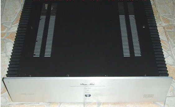

I started on the casework tonight and I almost cried. I'm recycling a worn out fostex rack mount 8 channel digital tape recorder as the case for the F5. Although the thing came from a studio and the heads were worn out, it was a real shame to gut the thing out. It was a lovely piece of engineering. You wouldn't believe the number of screws and crossbraces in this thing. It must have cost a fortune to make!!
Anyway, it will make for a nice case. Depending on how hot this thing gets I may add a fan... so I will be leaving provision for that. Adding even a small fan on my mini-aleph made a fair difference, dropping the internal case temp by 10 degC and dropping the heatsinks by about 5 deg C. Brings them back from 60 to 55. Nelsons controller circuit worked a treat (thanks)
Fran
I hve visited that website loads of times intending to buy a case there but it just never worked out, or I recycled something else to suit.
They seem very fair in their prices both for the cases and shipping...
I might just fit a wooden front to the amp but am a little concerned as to how it would hold up to the heat. Maybe a little spacer would help a bit with that.
Fran
