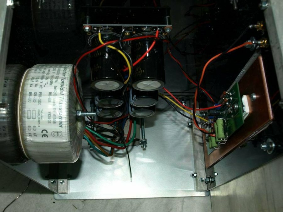

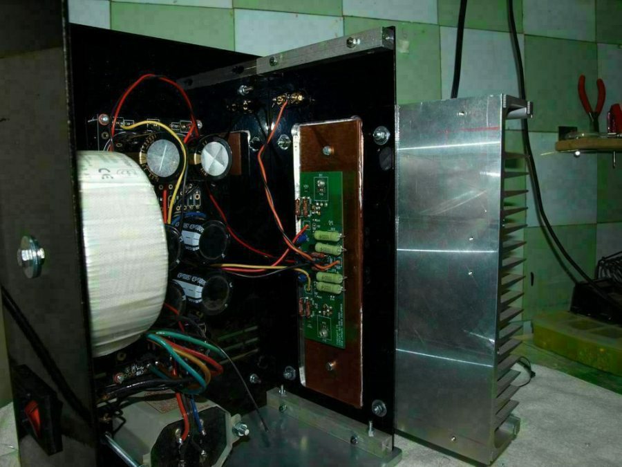

Hi guys I just make my first ever DIY SS amps.
It's mono F5 with BUZ900?BUZ905 transistors.
PS is CLC with UTC 2 X 30mH/2.5A/0.6R choke.
Amps run at +/- 24VDC with offset and noise under 1mV.
After all day playing at 1.4A current on each BUZ I get
42*C on radiator.Not bad I hope.
Now I like to ask Dear N.Pass here and all other person who
made this amps.
I feel that this choke in PS is waste .
How obout to use this choke as load resistors on BUZ
transistors ? I have a 0.5R Mills for now.
Thanks for any help and idea.

if you're talking about resistors between output mosfets and rails - don't even think about that .
in F5 - each output mosfet is load to adjacent one . source resistors are there for other reasons , not as load
