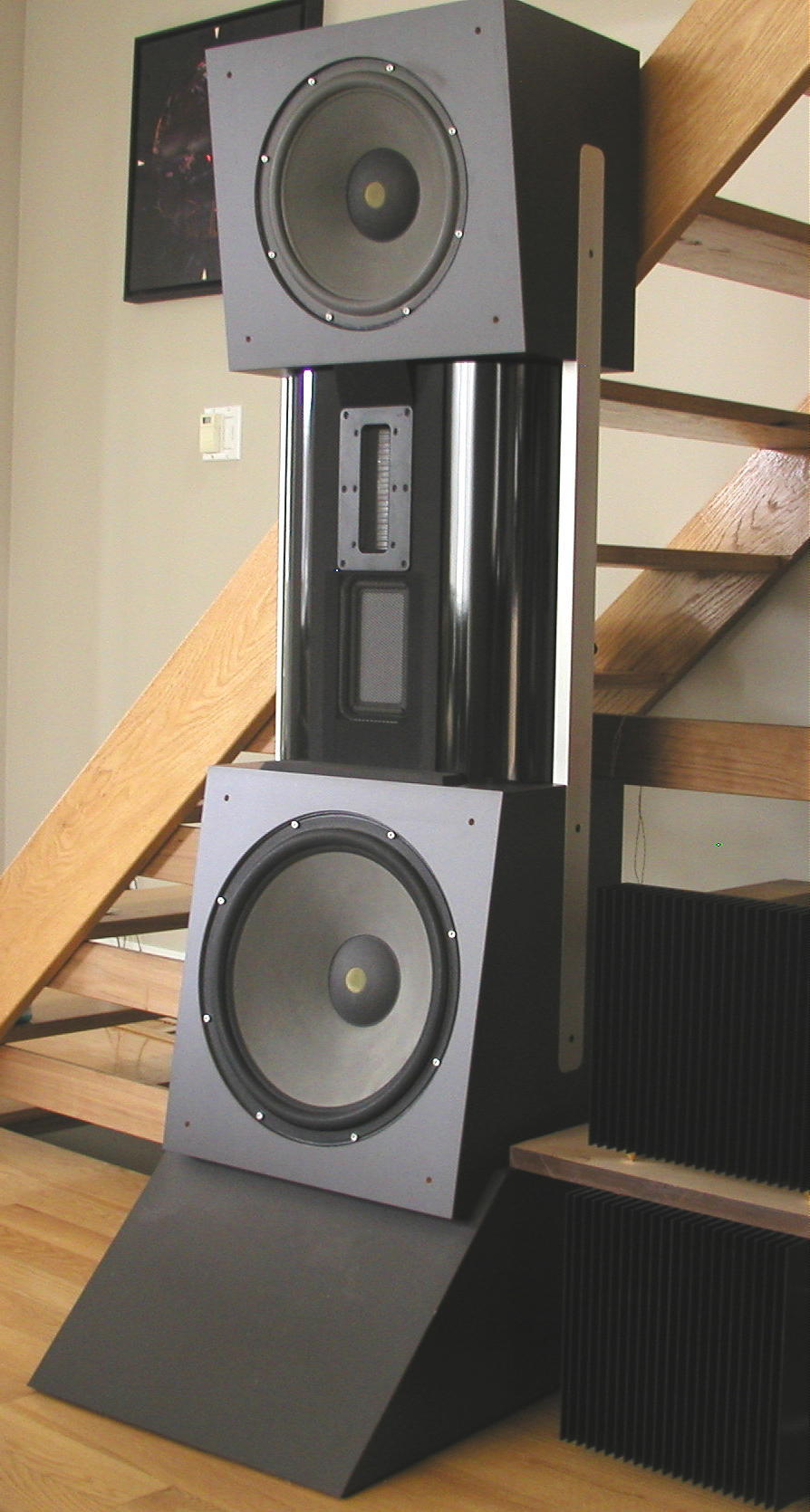

Peter, your speakers are gorgeous! What are the ribbons? Particularly what is the mid ribbon?
I was aiming at 120Hz (with 4 ohm FAL driver)
Did you chose your BG cap based on calculation or measurement, or you just wanted to give the most you can with the best available cap? My starting goal with all the experimentation was to settle on one amp for mid and tweeter. I have been running my system with tubes driving mids and Aleph 30 on the top. I kind of wanted to simplify, and look where I am heading 😛
I chose BG cap based on availability: next higher value after 100uF is 330uF in N type, and I just couldn't think of anything better for this application.
The ribbon is Aurum Cantus: I was using Raven 2 before and I don't see much difference in sound, but durability of larger AC ribbon is convenient, especially with 2nd order filter. The midrange is from FAL: http://www.diyaudio.com/forums/full-range/69176-anybody-tried-fal-drivers.html
The woofers of course are Focal. I've built those speakers in '96 and recently upgraded mid section, everything is open in a back.
Just plain awesome, my dear fellow ribbon lover!
