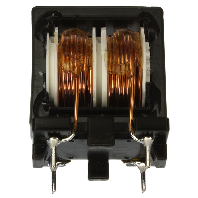

But the CLC offers a rather simple solution and need not be expensive if you accept the use of a common mode choke. Check out Digikey. I found a 4A choke with 6.9mH on tap for around $5 [PLK1332-ND].
That's a cool choke, and inexpensive.
However, it's supposed to be used in the AC line.
Maximum current is specified as 4A RMS.
Any ideas on how it will behave in a typical F5 CLC (CLCLC) PSU?

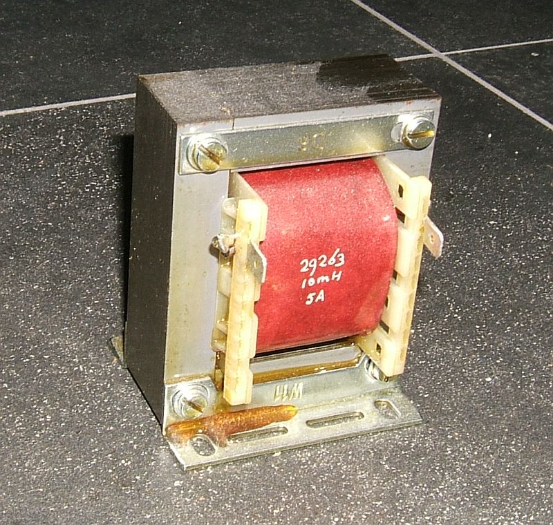

I bought my chokes from Automatic Electric Europe
They are rated 10mH, 5A DC, 0.0695 Ohm, size: 80x70x60mm
The price was 26€ for a choke.
The nice thing about them is the low DC resistance, it's almost impossible to make an air choke with the same specs or it will be enormous.

can you give us dimensions ?
dim. of lams , air gap , wire dia ?
it's always handy to have recipe

Hi Choky,
the diameter of the wire is about 1,65mm (14AWG)
The iron is an EI core,
outer dimensions seen from front like in picture: width: 65mm, height: 78mm, width outer lams: 13mm, depth lams: 28mm
so the outer lams are 13x28mm, I can't see the inner lams on which the wire is wound. But I'm guessing that it's 26 mm.

tnx 😉
if core is standard EI , then tongue is 1/3 of overall width ....... in this case height
so 78/3 =26 mm ,as you wrote

I can't get - what's height of lam stack ?

You mean with height of lam stack: the depth of the stack like in picture, that's 28mm
