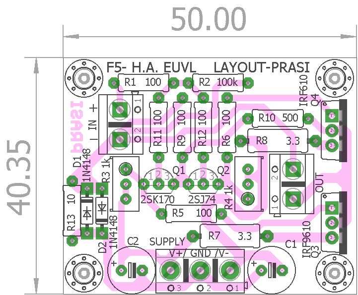

All the same, if some one needs to match the 'improvement' in sq, i guess they would need to buy.
Also, if only vero layout is shared, for a modern, common diyer, who can only build with1$ PCBs, there appears to be no option, other than making pcbs from the 'vero equivalent' layout posted by other dime-a-dozen layouters🙂.

Prasi,
Thanks for the layout! Looks great - these will help me make it look a little cleaner than my veroboard. Appreciate you taking the time to make it.
I would argue that the veroboard layout is actually "better", although a little bigger. Resistors are kept closer to mosfet pins, traces are generally shorter on the veroboard layout. But having a pcb might be easier for some people so it's a nice option.
