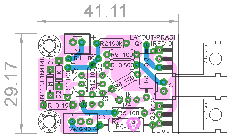

As per pcb layout on post 775, you could easily shorten the distance between R6 <-> Q4 gate by moving R6 underneath R8 (couyld move that one lower too)
You can use the leads on the resistors as direct connections between components and not need some of the tracks at all, especially some of the top layer ones
The 3 tabs for the IRF transistors don't need to be in line at all - there's no problem bending the 3 legs to different lengths for asymmetrical (?) holes
X2 connector can have right angle bent pins and be soldered from the top or bottom - same thing with R12 as it too can be mounted underneath so the 2 jfets can be bent to touch each other for temp
I'd be a bit inclined to separate the input gnd track and the output gnd connection (X2, pin 2 - you could maybe swap the pin 1 for pin 2, etc)
If you were so inclined, you could add a ground plane too altho not sure what advantage you could expect
just my 2 cents ....
Curiously, on my last amp I cut most of the pcb tracks and used mainly component leads for wiring (track pads used for mounting) - not at all surprised by a clearly better sound, in my opinion anyway!
Thanks for your suggestions, James
Provided a seperate pad near the mosfet pin, so that resistor can be connected from the bottom. Anyway, as it is, the resistor pad is just 8-9mm away from the mosfet pin🙂. it just looks to be on the other side town in the zoomed-in/ magnified image of the PCB.
I like to stick to the standard packages in my software, as drawing a new library package for every layout is not feasible.
X2 is a 2.54 mm pitch JST connector/ PCB header and connected from top when the mosfets are inserted from bottom., If MOSFETs are inserted from top, direct wires could be soldered or normal 2.54 mm PCB headers could be used instead of JST connector.
Yes, thats the idea behind placing the R12 resistor in between the JFETS, even when its on top side, JFETS can still be bent and coupled.
Done..
I do not prefer ground plane around the pads of components, as you can see, for both the gnds, there already a plane but its contour is controlled so that it does not go around any pads.

I see that you don't have any PS filter cap on the pcb, are you planing to add SMD e-caps to the bottom of the board or just connect directly to the cap multiplier?
Regards
I'll have some excellent quality 5mm x 5mm boards in about 10 days that will have provisions for PS decoupling caps and will also have greater component spacing for easier soldering.
If interested, PM me.
revised silk, as cam processor converted all the font to vector graphics.
Very nice design but I think it needs decoupling of the trails as silently introduced in post 40. Was asking this once in the original F5 thread and got a reply that it is worse to decouple it being a "high bandwidth device" ?!?!? Found that decoupling gave better results so a load of **** that was echoed for a while.
Please add SMD 1210 (or TH) decoupling caps to the board. A 5 mm (film) input cap would be nice too. Better a slightly larger but complete board than a small board with parts dangling in the air 😉 Since its purpose seems to drive headphones or to be a preamp I think the icing on the cake would be a stereo board with pads for volume control and a muting relay. And a PSU board and ... 🙂
