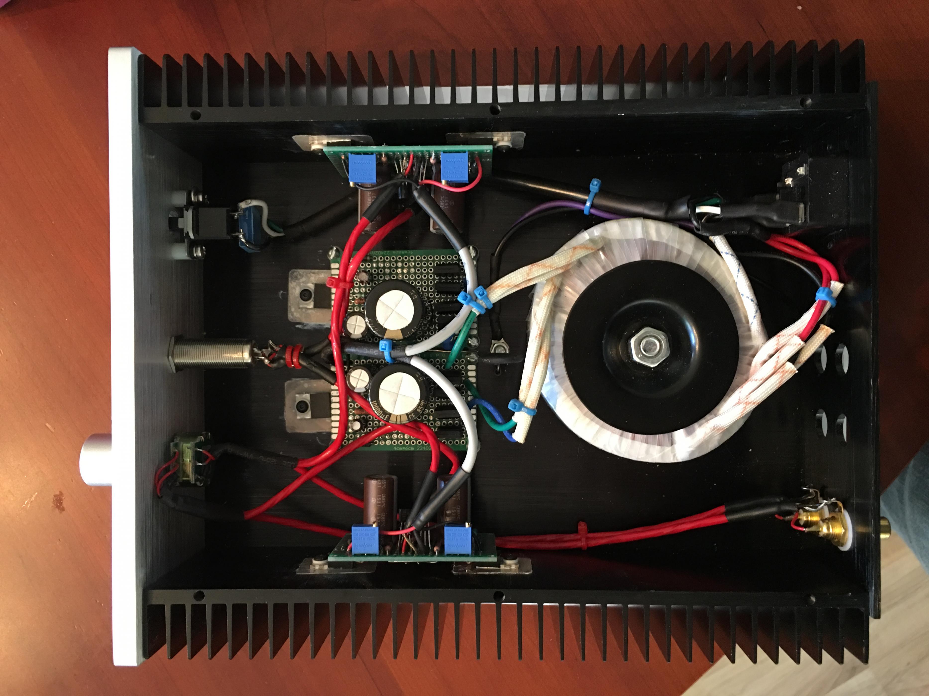

Do you cut/drill your own holes for jacks and knobs? The price on this unit with cutouts and knobs is actually less than some other "blank" ones.
The IEC inlet box is the biggest pain to cut if you don't have a milling machine.
I will probably mount the little amp boards directly to the heatsink side walls rather than use a heat spreader.
Will have to drill a single hole in front for headphone jack though if I get this particular unit.
I plan on film caps as soon as they arrive. Had to use ceramics just to test if it makes sound last night and to attenuate volume as way too loud on my headphones and also lets me turn volume down to connect/disconnect inputs.
Film caps for XF filter on order. Upon more careful reading of the cross feed writeup, I see that the point of the 12k resistor was to bring the 10k pot to a 5.5k overall impedance to be an ideal match for the Linkwitz crossover filter. Since I am using a 50k pot, a 6.2k resistor is what I need. Currently running a 47k there so the XF filter is probably not working as designed - still sounds quite good. So will correct this as well.
I do notice that the length of thin signal wire between the XF board and the main amps picks up noise if I get my fingers near it. Looks like it may be that the 100k input impedance of the amp is too high and results in easy stray noise pickup. But that impedance allows the 5.5k XF filter impedance to work without a buffer I think.

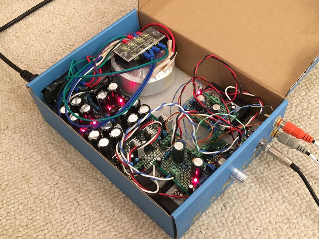

Test case - a paper box to check fit
I received my 50VA Antek toroidal transformer yesterday. I installed it and the rest of the amp plus all the ancillary stuff needed for a real standalone headamp. RCA jacks, headphone jack, volume knob, EIC wall plug inlet with fuse/switch.
I put it all in a small cardboard box to check for fit to see the minimum size box I will need. My PSU board is rather large so not sure if the usual 2107 aluminum cases are going to work here. Although in the 2107, the actual amp boards will be screwed to the side walls where the heat sinks are so that frees up some space.
I also fixed the output impedance of the cross feed module to get 5.5kohm, and I added film bypass caps to bring the 20nF up to 22.1nF. I also added my traditional practice of a 330pF 1000v ceramic RF suppression cap (it's on all of my amps thus far) at the input to the amp - which, in the case is the input of the cross feed module.
Stuffing it all into the box, it all barely fits and I try to keep the AC line stuff far away from the sensitive amp modules which have a 100k input impedance. I also tied the metal shell of of the volume pot to ground with a 10R resistor to prevent hum from touching volume knob. Amp ground is connected to earth ground via star at center of PSU cap bank.
Well, the short story is even in a cardboard box which affords no grounding or RF suppression, the amp still is dead silent when no signal is present. No noise pickup issues with the lines between the cross feed module and amp. I absolutely cannot tell it is even on if not for the LED glowing. The sound is fantastically clear and free of any audible distortion. Test tracks with bass that I am familiar with all play well with excellent reach and articulation. No lack of bass in this headamp at all.''
The clarity and dynamics are stunning. I think the correct cross feed resistor and now with film bypass caps (3x 680pF 100v per side + 20nF 50v ceramic), the soundstage and imaging are excellent. I have much more confidence now that this will all work well when stuffed into an aluminum box.

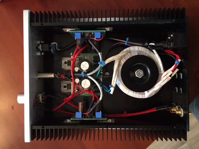

That's probably not gonna fit in a 2107 chassis. The 2107 is almost exactly 4cm tall internally on the heatsink side which means no downward facing mosfets on the 4x6 boards. I had to mount the mosfets side to side to mount the 4x6 boards on the heatsinks. And you have much more PSU size than I do . Better go with the 2109 chassis. It's taller. Here's a pic of mine before the cap multipiers in a 2107 case.
Hikari1: The 2107 is supposed to be 62mm high on the heatsink side..? (4mm top and bottom plates) - And im quite certain my 2109 have 82mm tall sinks..
