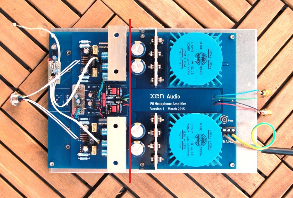

Can you use an external PSU (incl. regulators) with my PCB ?
Yes, it is designed to do so, and you may even use batteries.
You can cut the PCB along the red line shown.
Additional holes are provided for mechanical mounting, as well as 8 solder pads for +Vs / Gnd / -Vs connections.
You can still retain the Cross Feed Buffer in so doing.
The MOSFETs are bolted onto the bottom plate.
Any solid aluminium plate of 3mm or more will have no problems conducting the heat to the heat sinks.
You need to use thermal grease or foils between the two, without saying.
Patrick

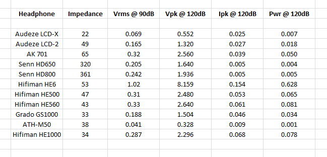

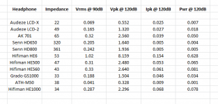

Hello Patrick. I have some headphone very hard. Is better make a F5 directly?
Attached is a table of the power hungry headphones I know of.
The standard F5-HA will drive all of them to 120dB SPL in pure Class A, with less than 0,1% THD, in most cases around 0.01%.
So I leave you to decide for yourself whether you still want more power.
Patrick
