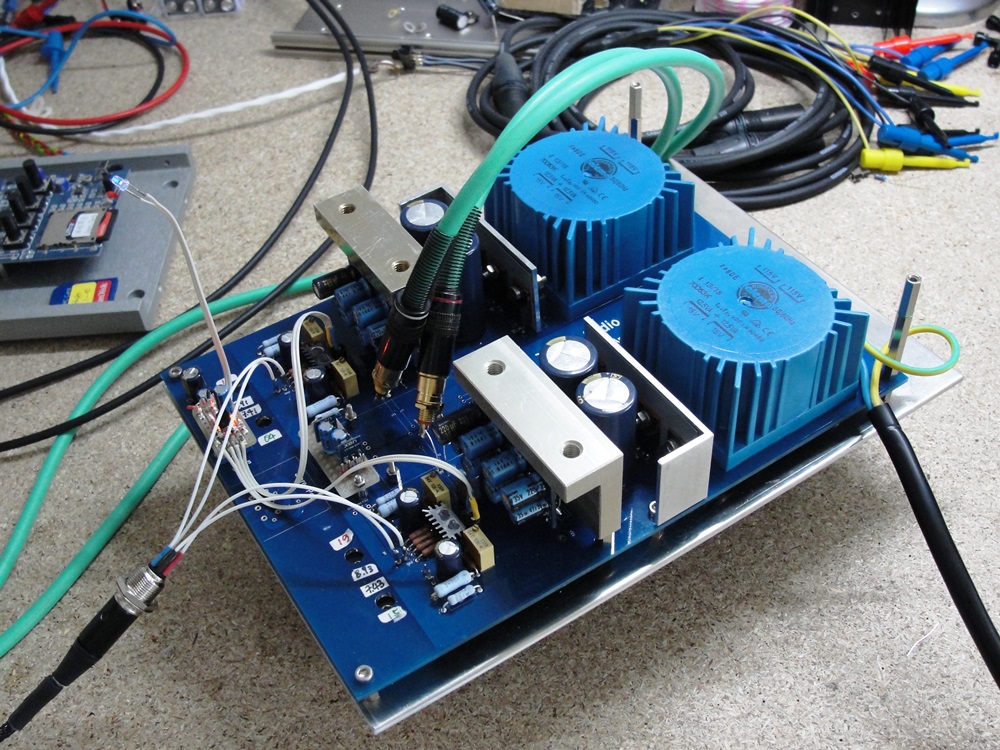

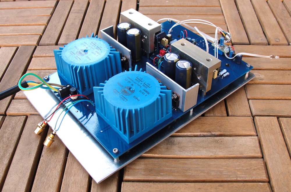

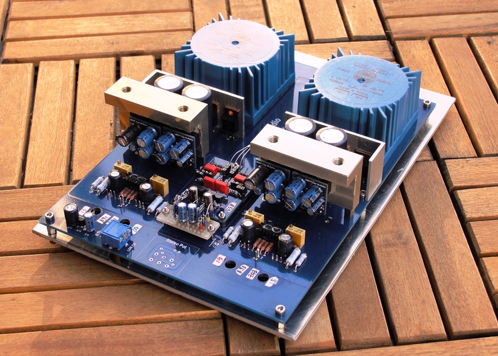

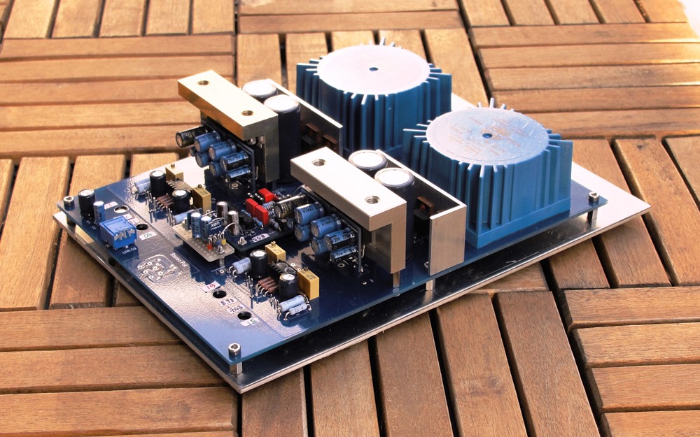

It is not the best weather for photography today. But here is an update.
Volume control pending, and not yet tested, and the regulators are temporary solution ......
Still need a few more days.
Patrick

First sound today (this one with Fairchild MOSFETs).
All worked first time, except one small layout error which was discovered before testing. (luckily......)
Simple rectification, and all worked fine.
It does not even affect anyone else than those (like me) using LDR volume.
A slight modification was also added to address a 1dB hump on the frequency response while using passive pot at -6dB.
A simple 47p mica cap was added in parallel with the input resistor to Gnd.
Flat response to 500kHz and above, depending on volume setting.
DC offset within +/-5mV.
Just case and cross-feed buffer to add.
Patrick

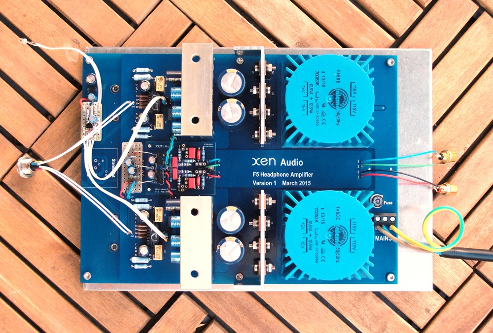

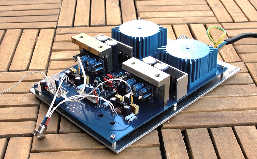

All sub-modules soldered and system tested fully functional today.
(Input / output / power cabling provisional, awaiting enclosure.)
The modified Linkwitz cross-feed buffer adds a realistic stereo image and for me at least it is definitely here to stay.
Very precise image, as one would expect from dual mono construction.
Really great sound for such simplicity, but you knew that already. 🙂
Patrick

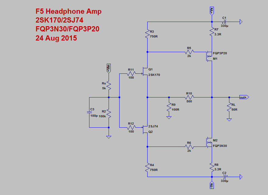

Someone requested an updated schematics for his Vero board build.
You should appreciate that it is still work in progress, there are many variations possible, .... So there is no definitive / final version.
And I cannot possibly keep posting every evolution I make along the way with proper documentation.
But I'll post one here which represents the one in post #277.
Drain resistor values depend of course on FET Idss and Vgs.
When the PCB is made available later, it will be accompanied by proper documentation.
These include, amongst others, a detailed circuit description.
Thanks you for your interest,
