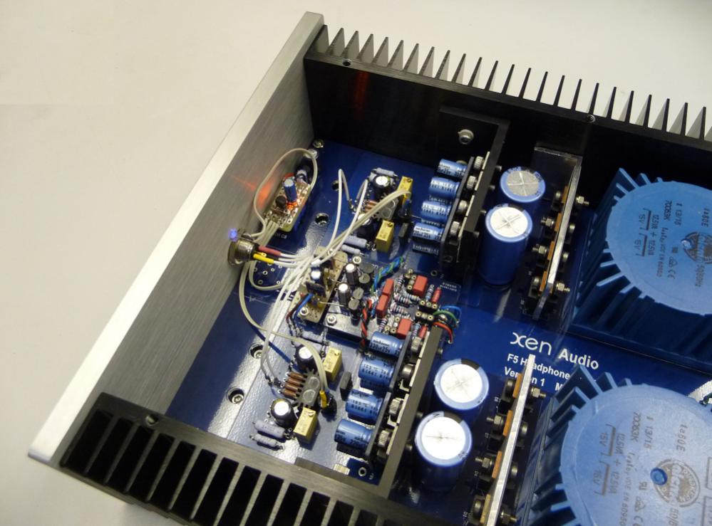

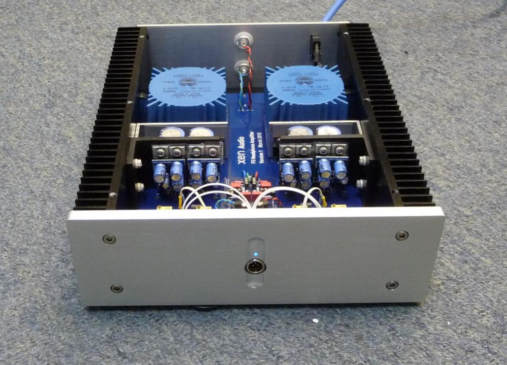

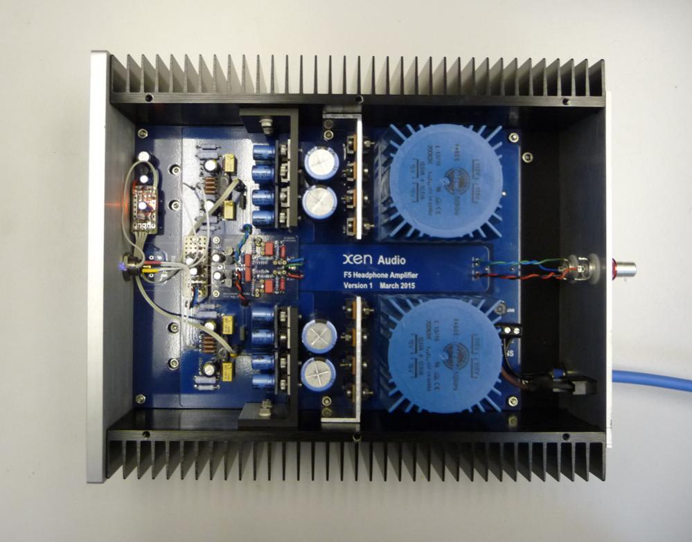

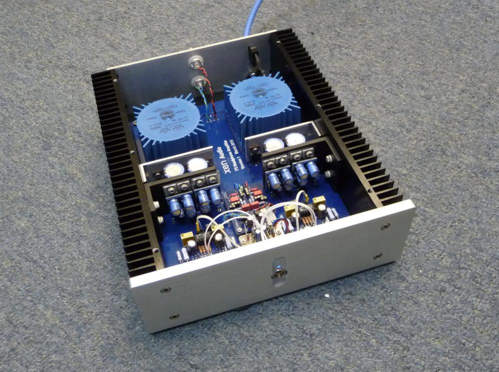

Not to be outdone by Cloud85 (the Beta Tester), I finally finished my second F5-HA today.
It will settle in it new home in a couple of days, with a very happy and thrilled new owner.
Patrick

A question Patrick. What kind of preamp you use? I don´t know much about the F5 design but I would like use a passive preamp (a pot and an input selector... your board have a location for a pot) and use a single chassis, but I´m not sure that it will be ok.
What do you think? use a passive preamp (like a B1) or use an active design? I would like something simple but effective.
I like it!!
I do not use an extra preamp, and the F5-HA has a normal RCA input that takes 2Vrms signal.
As you can see from my photos and those of Cloud85 at the build thread :
http://www.diyaudio.com/forums/pass-labs/283387-f5-ha-build-thread.html
the incoming signal goes through a cross feed buffer (optional and can be by-passed).
This contains a passive cross feed filter, followed by a JFET source follower buffer (call it B1 if you have to).
The volume control comes after the (optional) cross feed buffer.
The PCB allows for an ALPS RK27 pot at the front (centre), and you can also make a TKD or similar to fit if you move it offboard.
Or you can use an LDR volume as I did.
I guess if you have to, you can fit a rotary source selector switch at the back along the centre line.
And you connect that to a knob at the front through a long shaft between the tranformers, and above the cross feed buffer.
You will then need to move the pot to the side, or use LDR.
The pot for the LDR is at front left, and you can just see the hidden hand wheel bottom left of the front panel.
If none of the above suits your needs, then you are better off building it from scratch with Vero boards, rather than using this PCB layout.
One can only make allowance for so many configurations without compromising performance.
But thank you for your interest,
Patrick

Nice work Patrick! I'm sure your friend will be as pleased as I do.
For those looking to build this amp, I will highly recommend using LDR volume control 🙂

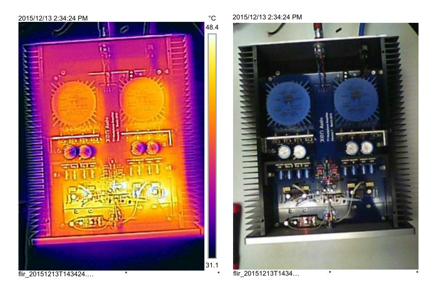

Gogowatch tried out his new toy (IR camera).
Picture taking after 1 hour running.
Only the JFETs were lightly warm to hand.
The case and the heat sinks were barely above room temperture.
Patrick

Is that a special heat detecting camera?Gogowatch tried out his new toy (IR camera).
Patrick
Or just an app on a smart mobile phone that has some infra red capability?

The amp was delivered to it new owner today.
A VERY happy new owner.
Patrick
