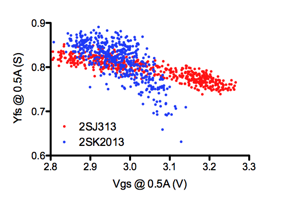

Question: mosfet matching for Vgs or Yfs? Looks like both it's not possible.
D.
2SK2013/2J313, or Fairchild ?
Nic seems to have matched Tosshiba's.
If you want min even harmonics then you need to match Vg and Yfs.
Patrick
Patrick
I don't remember seeing that plot before, but I suspect you have shown it elsewhere.
Am I reading it correctly when it appears to show that the Nchannel spread of Yfs (gm) is much higher, than for the Pchannel?
Yes, but still a very decent number of complementary devices with very good matching for both Vgs and Yfs.
