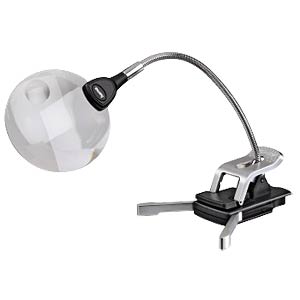

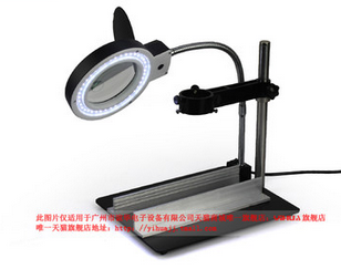

Thanks Patrick for the hints, just ordered a sharp tip and a 8x magnifying glass with light from TB, all cheap stuff but hopefully sufficient for the job.

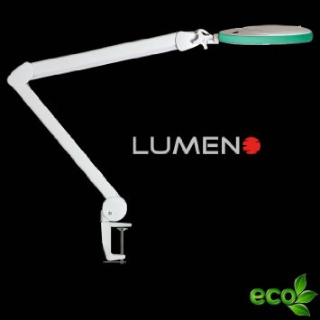

You know, I also bought a new LED magnifying lamp last year, even bigger than yours with long reach as well. Quite high end.
I ended up not using it much, because the lens and the LED take up too much space.
So while you have very nice image, your hands and more important your soldering iron cannot get to the PCB without the lamp being in the way.
In the end I bought another simple, small magnifying glass, and use this most of the time.
The LED lamp I then use only for inspection after soldering.
