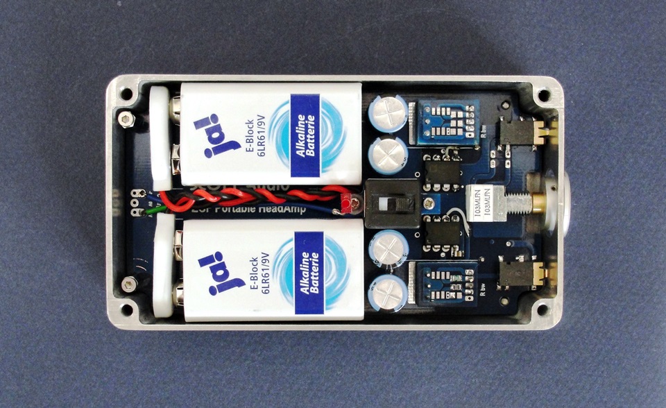

> I am also in the middle of a new portable design with Zero Global Feedback but using IC's.
> It has a gain stage with ZGF followed by a follower driver stage, using 2x 9V batteries.
> It also has a cross feed buffer, all in a Hammond 1550B case.
http://www.diyaudio.com/forums/pass-labs/271926-f5-headamp-7.html#post4523035
Shown here without the crossfeed (to make testing easier).
Already listened for some 3 hours with alkaline batteries.
More to come in a separate thread once fully finished.
Patrick

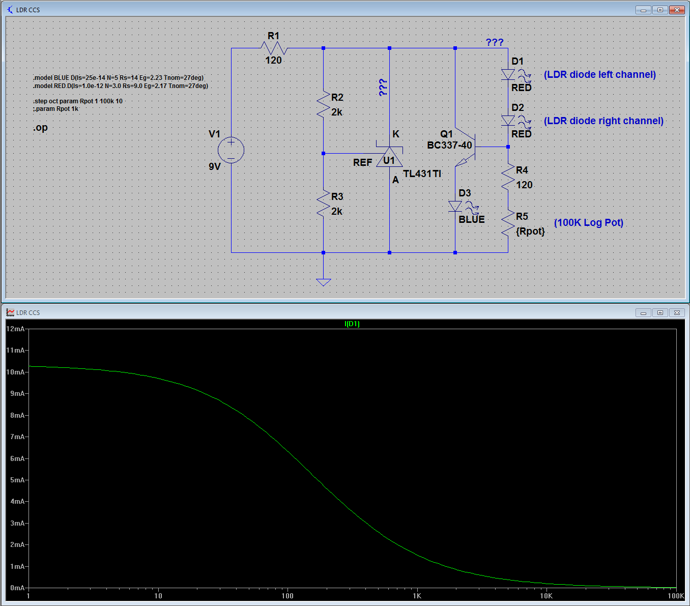

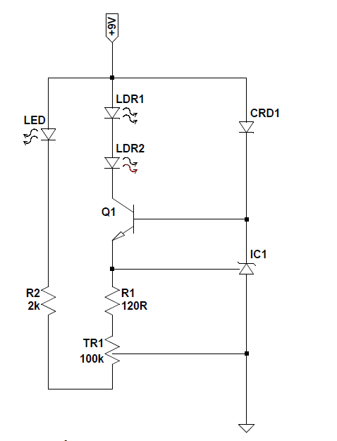

Hi Patrick,
In the official build guide (http://xen-audio.com/documents/f5ha/F5-HA%20Description%20V1.4.pdf), the BOM of the LDR CCS is given on page 19. However, I cannot find the CCS schematic in the build guide.
Is the attached a correct guess of the LDR CCS circuit (using the components from the BOM)?
Thanks and regards.
Thanks and regards.
