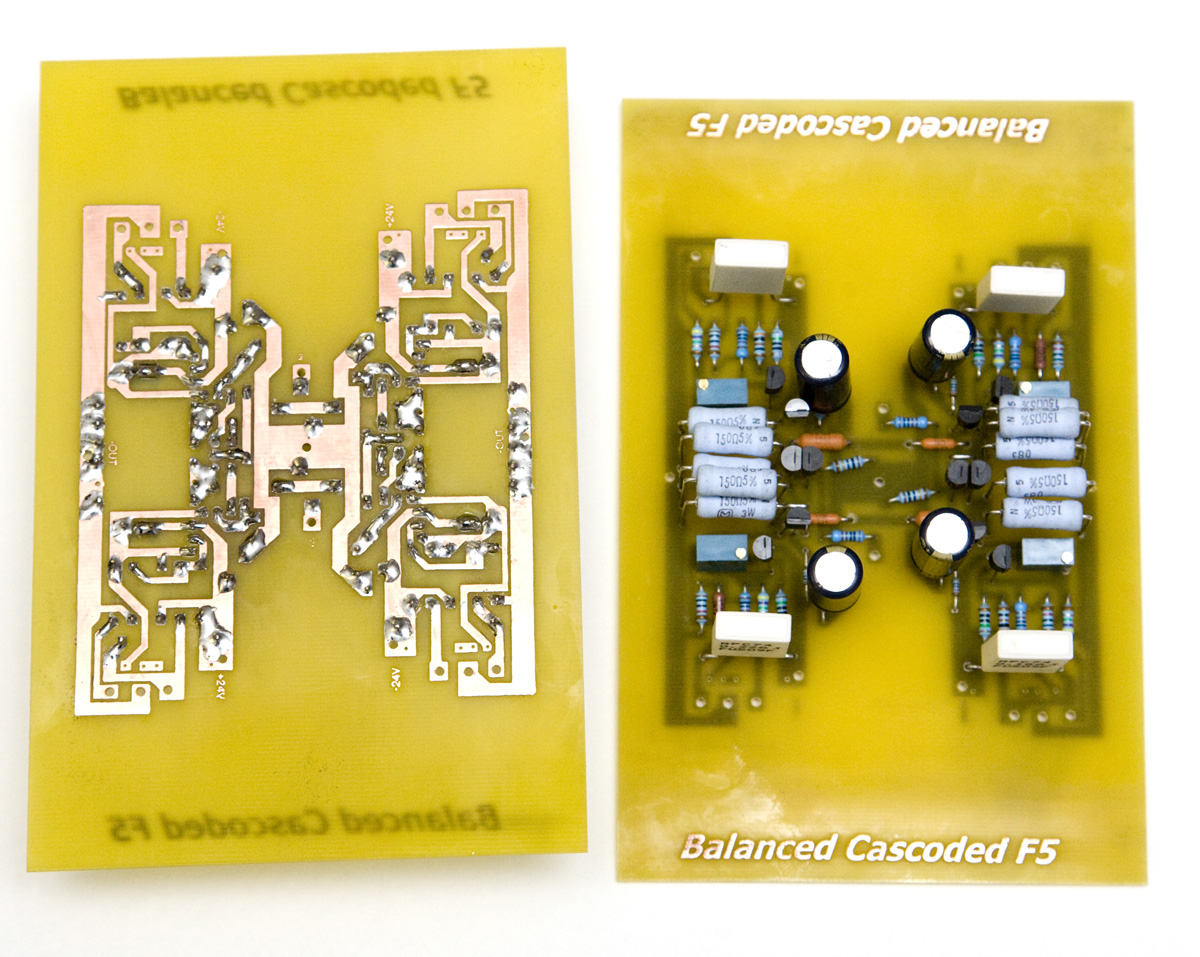

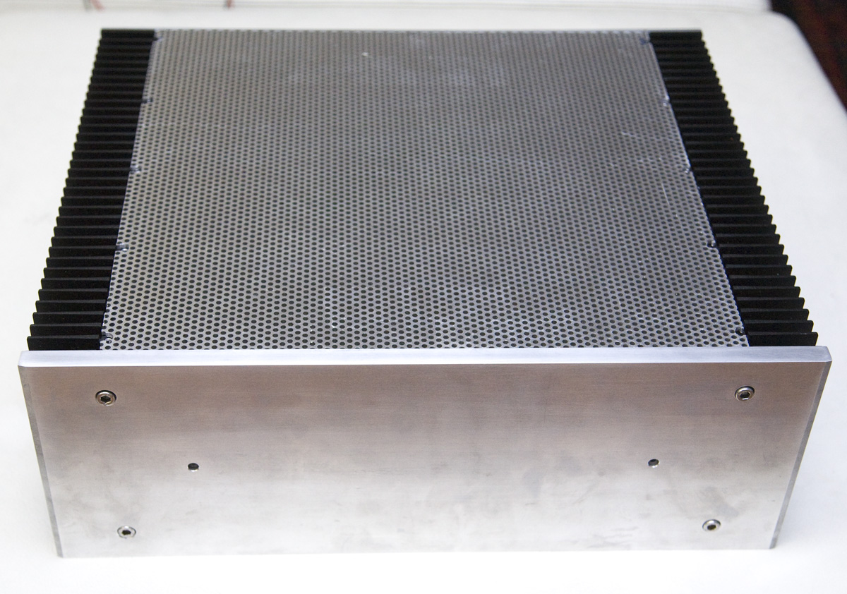

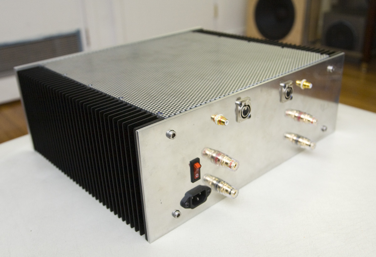

My day job got super busy, the USPS misplaced some parts, and the build just got slower than I'd hoped, but...
Below are pics of:
Below are pics of:
- The finished PCBs for the Balanced-Cascoded F5
- The back of the case I'm using
- The front of the case I'm using

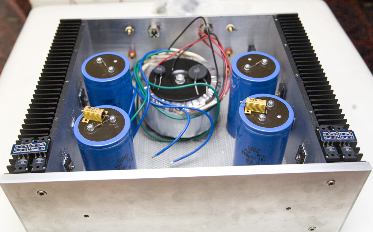

- The innards - four 68000uF caps, MUR3020 diodes, two different sized NTCs (the big one is just for fun), my 800VA 12V toroid (good to 1000VA), and my Toshiba MOSFETs mounted to the Conrad heat sinks.
ur much better off with the caps as close together as possible.
I'm waiting for the cap mounts, I've been thinking of putting them sideways with their bases attached to the front plate. The only other idea I had was some sort of jig to hold them together - keeping the front plate clear as a heat sink for the diodes and chassis resistors.

Below are pics of:I'm using 2SK1530 and 2SJ201 and I'm getting 20 pair of Toshiba 2SK3497/2SJ618 to try too. I hope to jury rig it togther this weekend.

I forgot to mention, I ultimately went with a voltage divider that sets the base of the cascode transistor to 11.5V (10K ohm and 22.1K ohm resistors with 16.785V rails). That's as good a starting point as any. It's easy enough to change lower or higher once I'm up and running.
With the external metal case of each cap being at 'ground,' one can arrange them to 'shield' (or 'deflect') electric fields (although not magnetic fields) from rectifiers and transformers. But that is probably a more theoretical (or visual) improvement than a measurable one, and I'd like to hear other opinions on this...?

These caps won't fit upright. I have smaller ones, but I was hoping to use these (68000uF each). While it's rare, I have seen a few pics of folks mounting caps sideways. My search of the forum did not yield results on the issue, can you point me in the right direction?

I would put them on their side, not upside down. The real issue is I bought these for a song ($10 each). If I need to replace a year earlier because of side mounting, I can spend the extra $10 each.
None the less, I'll start by testing with my standard F5 caps which are 8*18000uF.
