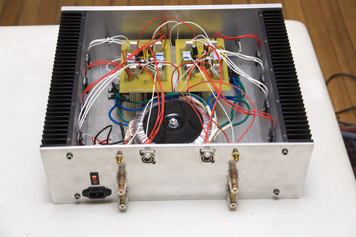

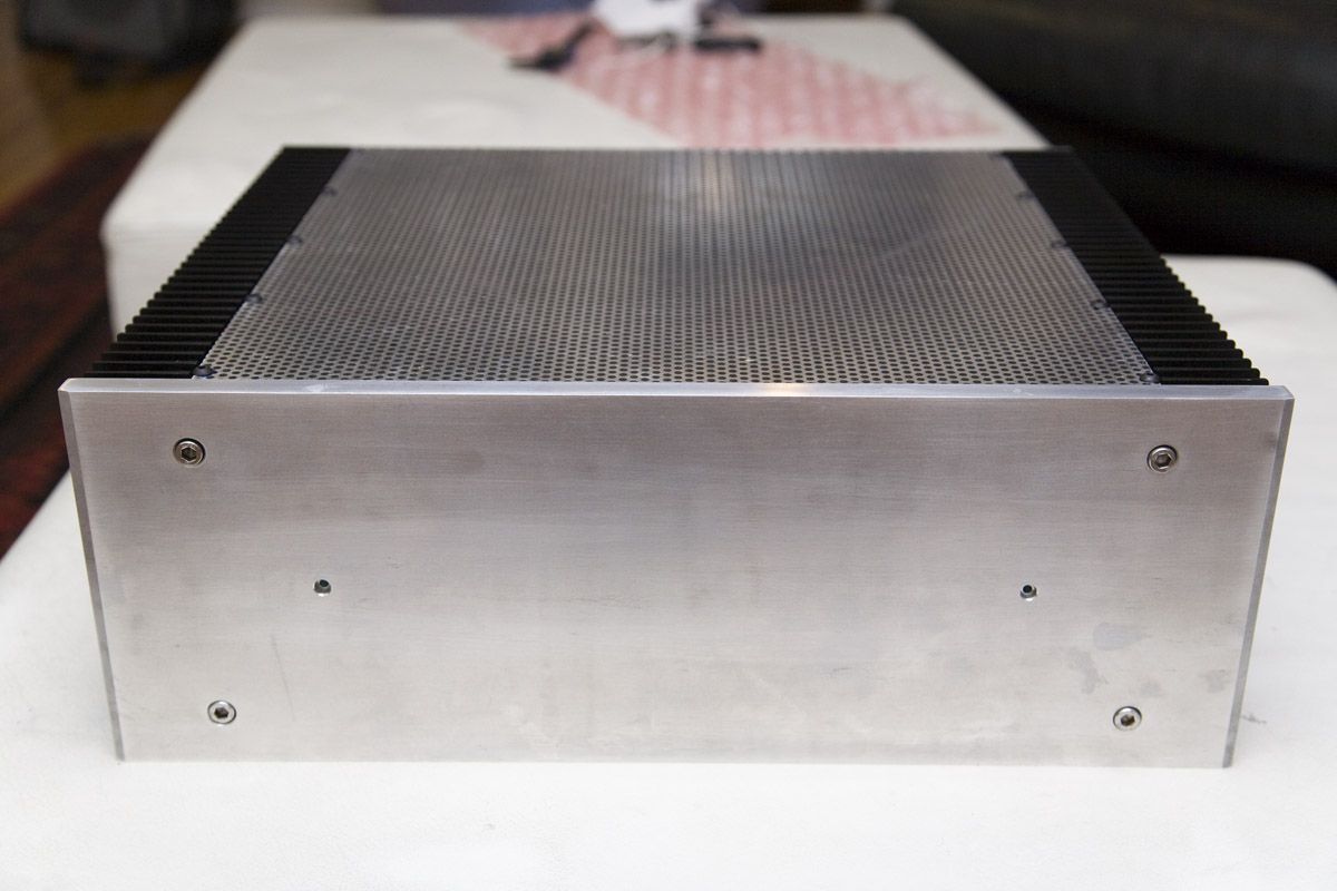

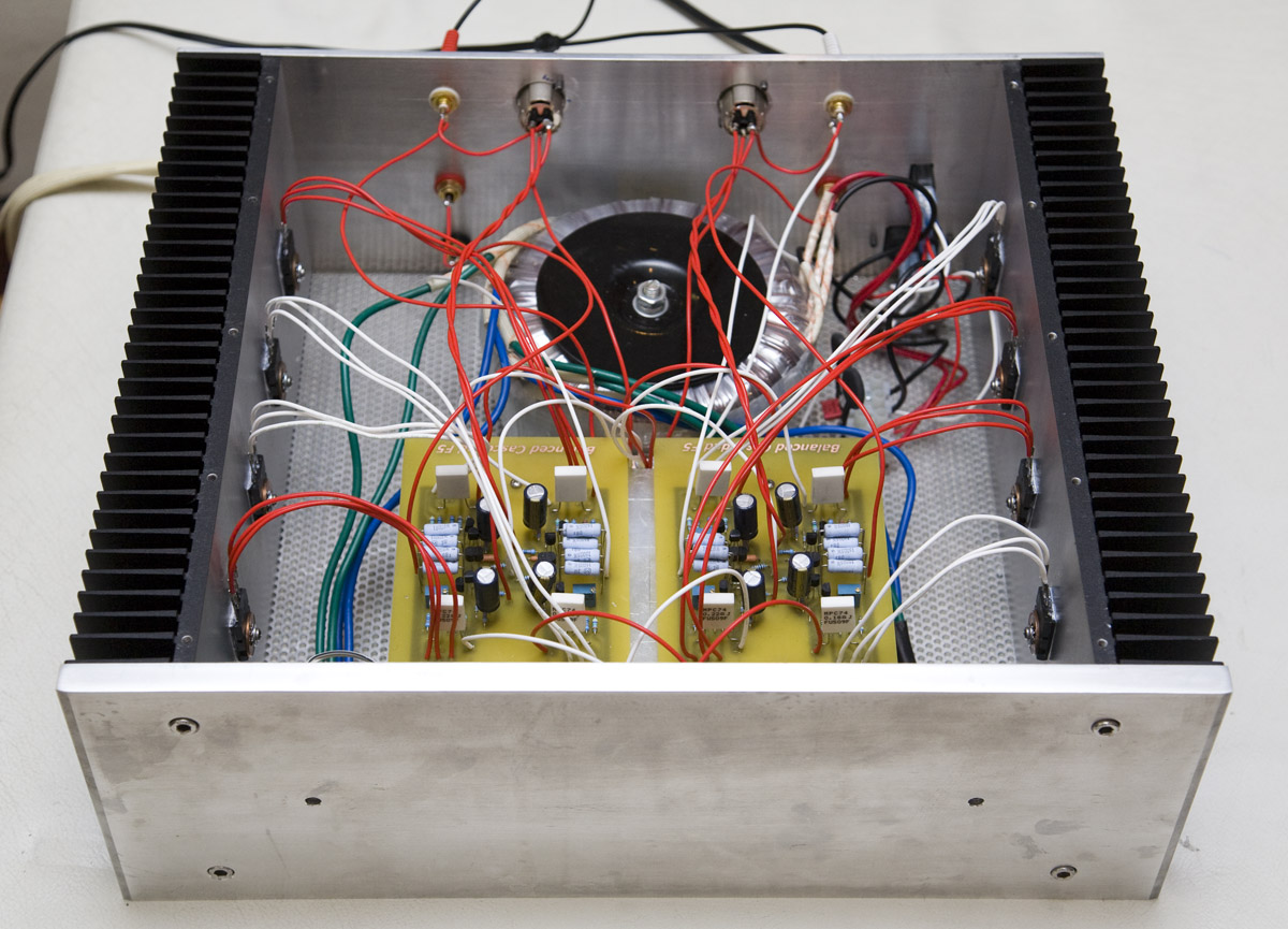

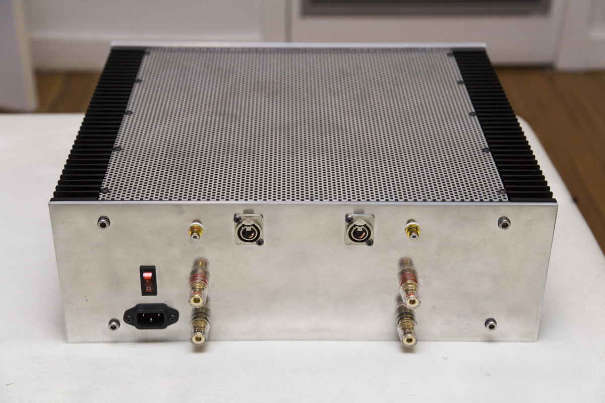

Here are a few pictures of the Cascoded Balanced F5.
I'm very happy with the how the project came out. I still have a lot to do. This case was intended for a very different amp, and has been pressed into service to test the Cascoded XF5. It is in no way the amp's final home - I have eight large heat sinks that are waiting for these PCBs.
Most of the "To Dos" are cosmetic. The only issue is a faint 60Hz hum (I can hear it if I put my ear to the speaker). I suspect I need the rotate the toroid to the front of the case and put the PCBs at the back (nearer to the inputs/outputs).
The sound is superb - the best I've ever had. As this thread states, I'm trying for the ultimate F5, my next iteration is the Standard Cascoded F5. The PCBs are built and work. I have a case, I need to buy a new toroid and I'll be off to the A/B listening tests.
I'll post more pictures as I swap my NTCs, add feet, rotate the toroid, route wiring to be neater. I hope to have the Standard Cascoded in a test case in about 10 days.
Finally, I cannot thank NP enough. He's a true gentleman and an extremely good teacher.

NYCOne: Before you move the transformer around, perhaps you should try shielding the signal input wires (from input connectors to the pcb) to hear (or measure) any effect on the hum. If nothing else, it might provide good experience for future layouts?
BTW: How much PS capacitance is there? Perhaps there is not enough?
Andersonix and Tinnitus, I have thin shielded coax, would this suffice?CanAm Man, I do not have an oscilloscope, but I live in the center of Manhattan and invite anyone who's interested to come over to measure the amp - I am interested as well.
