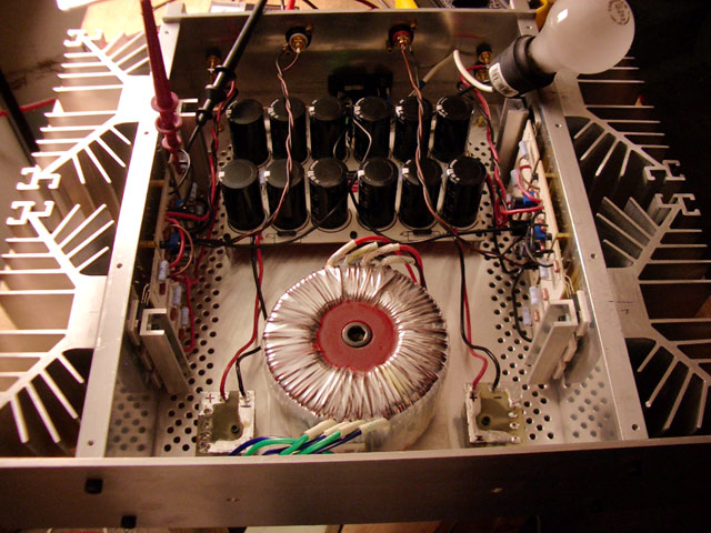

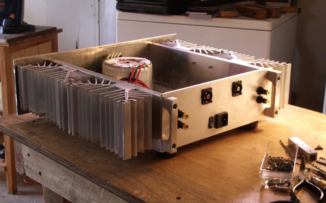

I machined it out of $2/lb aluminum from the local metal recycler. The PS board is a supersized cvillers 'simple CRC'. The F4 Board layout, with a few modifications, is Veteran's. Thanks and thank you... Mr Pass. On power up , I had the same bias issues as lykkedk with voltage variations across the source resistors. All the same, It still sounds wonderful. Compared to a 69JLH (bi-amped to 120hz) The F4 really grabs my ls35a's by the scruff. On the high end, where the JLH is a little tubey and forgiving, the F4 has extended, detailed highs.The F4 also has a tighter, much less laid back midrange. I'll shut up now and sort out the output bias.

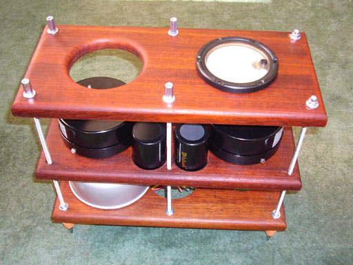

Some interest was expressed on the Burning Amp thread as to how I am coming along. I'm going for a bit of a classic look..
Here is the power supply for one stereo F4 which I will be using as a single balanced channel. There is another of these for the other amp.
On the first floor: 1000VA toroid run at 220 configuration on our 120 lines to get correct output.
Second floor: Pi filter with 30,000uF caps, the creamy choke👍 filling of two toroidal chokes, then two more caps....
Missing is bizarre heatsink tower with actual amp boards..
You can see the whole thing(s) at the show!
