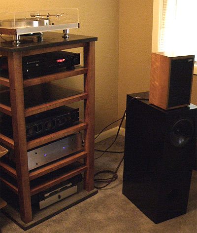

Variac said:Some interest was expressed on the Burning Amp thread as to how I am coming along. I'm going for a bit of a classic look..
Variac..
Hey that's literally a component rack...very cool!
19th century mad scientist look
Captain Nemo, your F4 is ready!
A shot of the "bizarre heatsink tower" please.
-Mal
pic of maple/concrete rack

Thanks guys for your very kind comments. I hope my wife feels similarly
I think she suspects though- it is being built on the kitchen table!
I have to leave the Bizarre Heatsink for a surprise at the Burning Amp show. It is more big than bizarre anyway..
