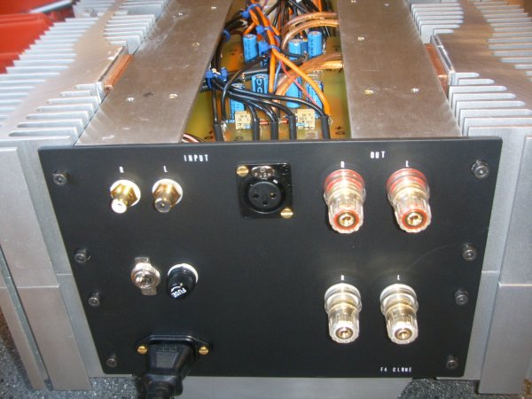

Hi all, i am in for listning to my F4 right away. So i have this quistion :
If i bridge the F4, what will actually happend ? lower distortion, and nothing more, ofcause the capacity of currency will double, but voltagesving stays the same ? I will stay at the same listning level right ?.
I simply can't understand why the distortion will be lowered, could someone explain ?
I will just short the input and output and give it a try later, but i like to know what happens CAN SOMETHING go wrong here ??? 😕 ...

I am not sure, that you are right here. I have two F4 monoblock's, and will bridge one for LEFT, and the other for RIGHT. The pre i have, has only singleended out at the moment..
Jesper.

I guess the setup you are refering to is to simply run the two channels of each "box" in parallel as monoblocks. With that you'll most likely get the ability to drive lower impedance, but besides that I doubt you'll get much improvement. I guess you can get better performance in this aspect simply by turning up the current (provideded you have sufficient heatsinking and psu capability).
Running the output stages of F4s in parallell is something completly different than balanced mode.
This will surely give more juice for difficult loads like old Quads (but NP said it sounded good on these already, or was that the F3?) Instead of parallelling F4s one could make a F4 with more output transistors, but of course there's a limit to that (driving their gates) which NP probably can inform us about.
If I was going the F4 route I would first listen carefuly if one plain F4 circuit per speaker would do. If more swing is needed I would bridge F4s. A >20 V swing balanced preamp would then be needed. Look to www.passlabs.com or for DIY follow the Curl BlowTorch thread or look to Erno (www.borbelyaudio.com).

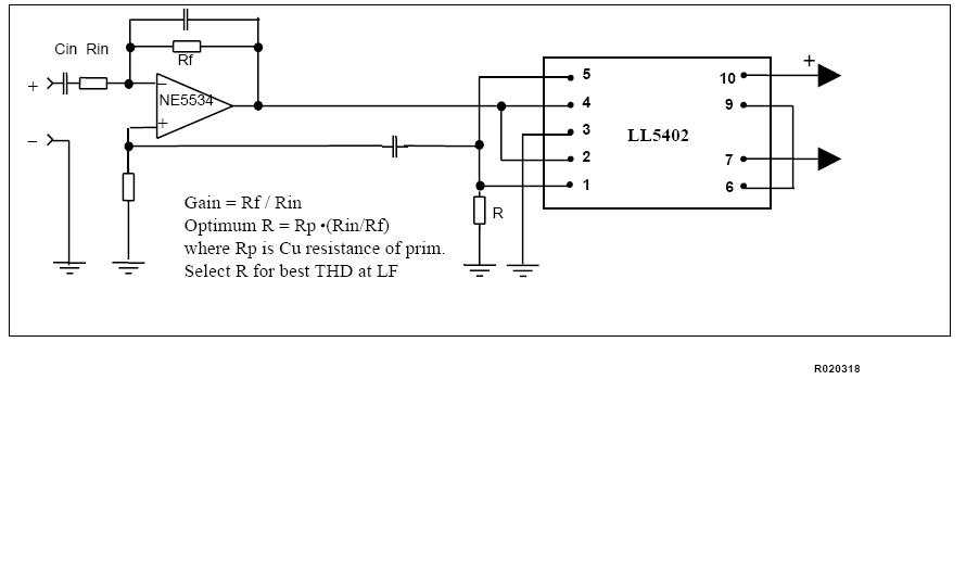

Might be a quick sollution with an audio-transformer, how does that work ??? Just for temporary use...
Jesper.
Jesper.

Have a look here http://www.lundahl.se/pdfs/datash/5402.pdf
The Lundahl LL5402 is intended for unbalanced drive, e.g. a single opamp as shown, or probably more or less any decent preamplifier. But read carefully through the data sheet.
