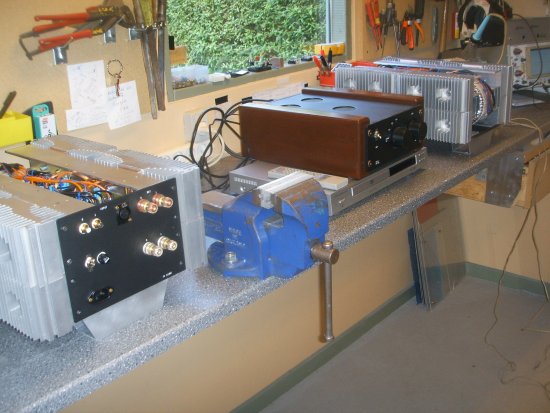

No amp... 😀 2 amp's ! have a lookBy ZenMod : amp.... what amp?
Well it wasen't supposed to be shown yet, as they are not finish. But the other day i paniched, and accedently showed a pic... So what the hel..
Here is how far i got till now : Both amp's fully tested, and played some hour's. The temperature settles around 40-45C after 1,5hour and becomes 'termic-stable' here 😉 Bias is 250mV (pending between 243-252mV around the six mosfets on each channel. I still need a faceplate, (wood perhap's)but havent made my mind up about it!
I got 1 quistion today. I have a thermistor CL60 in serie with primary, which must eat around 0,9A / 230V and it grows really hot (around 60C) is this normal ??? 😕
I have uploaded a few more pic's on this website here
ENJOY.
Jesper.

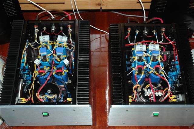

I have finished my second F4 amp today. Distortions as below:
Left: 0.016% @ 1W and 0.03% @5W
Right: 0.017% @ 1W and 0.035% @ 5W
All 1kHz, 8.2 ohm load. Bias 1.5A each channel.
I used it as balance mode and the bass is much firm and strong than single unit guess due to higher power and match up with my Bal DAC. I would say it is another step better!
Thanks NP for sharing this wonderful design.
Spencer

Great job Spencer, very attractive babies, congratulations !
Could you let us know about your enclosures, seems to be galaxy...
Thanks for the answer.
Very good looking F4 pieces, I hope to design mine as successfully as yours.
The enclosure has two version but my final version is 200mm height x 400mm deep x 350mm wide because I manage to find a supplier of heatsink of 400mm wide x 50mm thick in China. I design the case with all drawings and ask a metal shop to custom made for me for a total cost about US$200/ea. Face plate is 10mm wider/taller with 10mm thick and all polished and anodized per my spec. All the plates and heat sink are connected together with 12 pieces "L" sharp bar with either holes or tapped holes. Total weight of the case is 13kg net and completed amp is over 20kg.
With this size, the temperature rise is about 18 deg C max.
