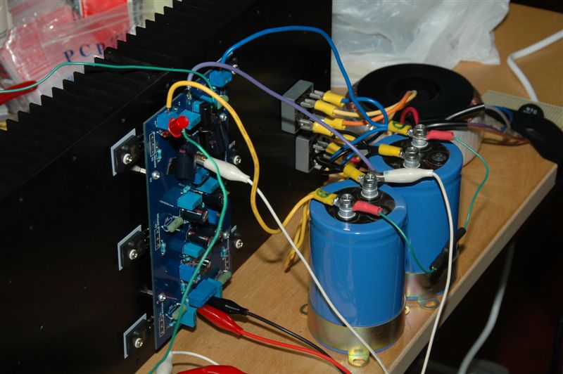

here's a picture of my initial setup... (I have changed R9 into 6,8kohm, else the bias wouldent go higher than 100mV)

spencer said:My heat sink arrived and will fire up soon to see if the heatsink is big enough. I still use 100R gate resistor and 0.51R source resistors for power mosfets. R8 changed to 27k. R3 & R4 still 22R.
Excellent job,! Congrat's.
Nice sinks... Is it because of lower heatdissapation, or anything else, the bias is lowered to 200mV ? Does it then run lower in klass A ??? Sry. i don't understand this !

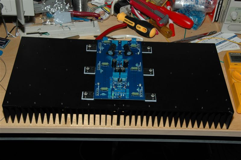

Tested one channel and the result is quite good on scope. Distortioin is 0.2% at 4.5W output. K170/J74 bias at 5.6mA using 22R source resistors. The matching of IRFP240/9240 is quite good also and current is from 0.48 to 0.49A and variation is within 2% for bias current.
Only waiting for the metal plates and support bar of the casing and then I can assembly the whole amp.
