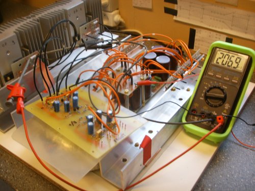

Thanks NP, for the new schematics...
Actually, i am just in for testing 1 channel (1 of 4), today, and see, the newest schematic of the pcb/powersupply design, and how the thermistors are attached, just how i did it 🙂 on my 'connection' pcb.
I am planning on replacing the resistor value R3, R4, R8 + gate resistors to they're new values... But later on...😉
I see, that the powerconsuption is a little higher now, and that the bias has changed a bit. Maybe someone could explain the advantages of theese changes ???

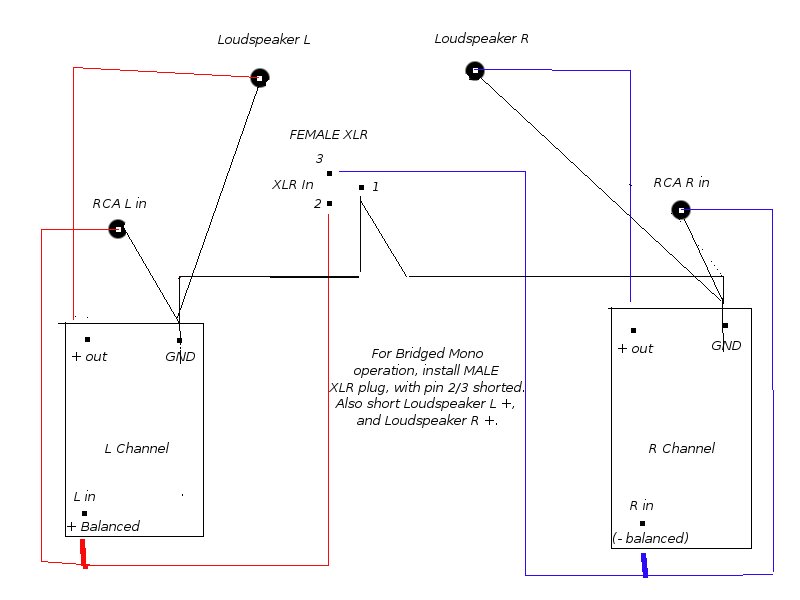

I would also, like to know if theese connection, i am planning is right :
1. Singleended input : (+ in / GND). And jumpers in XLR in - to GND. Loudspeaker between out and GND.
2. Balanced Mono : XLR in +/-, Loudspeaker between + out / - out.
3. Bridged Mono : Singleended input + connected to booth channels ???
I am planning to make all, theese possibilities, but it's a bit hard for me, to figure out how to do this excatly
Anyone have a schematics of how to do this right ?

Yes that's right. Take a look at the back of the original, and it will all become clear to you.

Hehe... ok cool Magura, but that's not something i have a picture off. !!! (I feel it's something different you try to tell me through
Well, it's the connection's to the three different's setup's i am interested in 🙂
here's a picture of my initial setup... (I have changed R9 into 6,8kohm, else the bias wouldent go higher than 100mV)
Jesper.
Cool - you're almost finished! 😀
If you skip back a few posts you'll see the original F4 (http://www.diyaudio.com/forums/showthread.php?postid=1260700#post1260700).
I think you should just focus on one configuration if you are confused about how to connect it together - do you intend on using it as a stereo block in the beginning? You can always wire it for the other configurations later.

Ohh yes... i have seen that... I just would like to make it, as if it was the original thing, where everything is fixed with shorting-plugs etc... 🙂 ...
I will run it as a stereosetup for a start, while finishing the other monoblock could take a while (Well i am not Steenoe GRinnsHH*-!#%) 😀
I have been testing this channel for more than 1hour now, and the heatsinks are nearly thermic stable now i think.

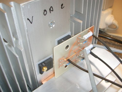

Another pic...
Another pic...

No, really, take a look at the back of the pic in the link from Christian. You see two sets of binding posts, 1 XLR and 2 RCA's, that fits pretty well with your own description.

If i just sometime would use my head, before asking.... sry guy's
This should be it, as i just read in the F4 manual !
RIGHT ?
