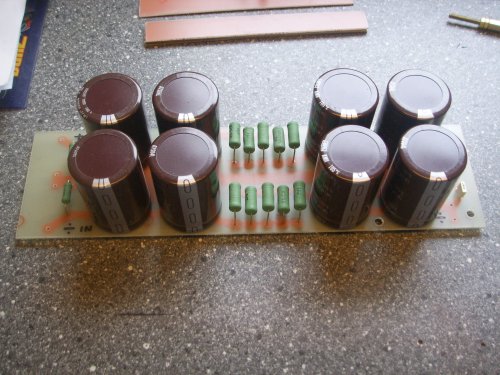

While my really slow F4 Amp. progress is going on. 🙂 I am right now making the psu's. At the top of the psu, there will be a pcb with connections to 2x18v torrid 8xdiodes and fuse.
My quistion is, if it's wise to put a CL60 thermistor in series with the hot live 240vac wire ? And what about the fuse, is it best placed at secondary or primary ?
Are there other things i have to consider about the psu ?
Attachment is 2channel psu
For safety reasons it's much better to install the fuse on the primary side, These days you do get transformers with a built in thermal cut-out switch on the primary winding so called short circuit proof transformers, but I still feel safer with a properly rated slow blow or time lag fuse in the primary.

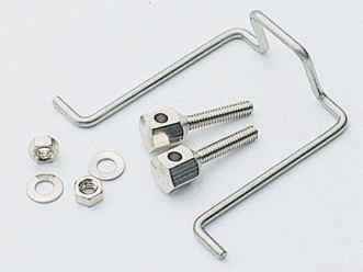

I make the mains part of my amplifiers in the following way:
- IEC mains inlet. Ppreferably with a Bulgin KT0006 (see attached picture) to secure the mains cable from accidentally being pulled out.
- Fuse on each phase (two fuses). Located on the back panel for easy access.
- Mains filter. There is so much noise around these days so I find this a nice precaution.
- Mains switch. Located on the front panel for daily easy access.
- Mains transformer.
Also, a varistor may be used to protect against overvoltages/surges on the mains. Located after the fuses.

I would have the varistor to short the phases together and/or to ground. This will happen quite quick, and if the short sustains the fuses will blow, and the varistor(s) survive.
Powwibly one could have a PTC or two in series with the mains in to protect as well.
Further, the toroidal transformer has quite an inrush current, so some limiter could be of good use. I think Erno Borbely still has such kits. The basic idea is to let the transformer have som series resistance at the input during startup. After a second or so the resistance is shorted by a relay to give zero resistance. The problem can be that this large turn-on inrush current trips your automatic fuses in your fuse box on the attic!
BTW that mentioned Bulgin part is ELFA order no. 43-212-04 (nice for you to know as I see you reside in Denmark). 😉
RK
Ohhh... I forgot,in Norway you don't have any 'cold line' you got 3x230vac, here in DK we have (You proberly know) 3x400vac + cold ( 0 ) Between 2 phases we have 400vac, and between cold and 1 phase we have 230vac...
