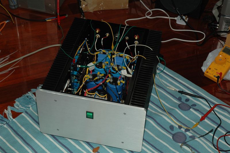

Mr. Pass,
I do not have 220uF capacitor handy for C4 and C5 and I am now using a 330uF capacitor. Is that fine? Yes the drift of DC at out put is easily adjusted within 10mV. The drift is mainly on the bias of the mosfet when the amp warms up (from 0.3A till 0.5x A per fet).
Spencer
Spencer
spencer said:..........
Spencer
sometimes even your ( or mine- whatever) fancy schmancy 220uF elco have enough tolerance to approach 330uF in real life ;
accent is on "sometimes" , but that's the fact.
so- why worry........ at least not in that position ............
OK ... thanks guys ... looks like a DC servo is overkill with the F4 topology. Great forum, thanks.
Also, R-K, thanks for answering the C3/R25 and C4/R24 question with a Pass original quote. I appreciate the clarification.

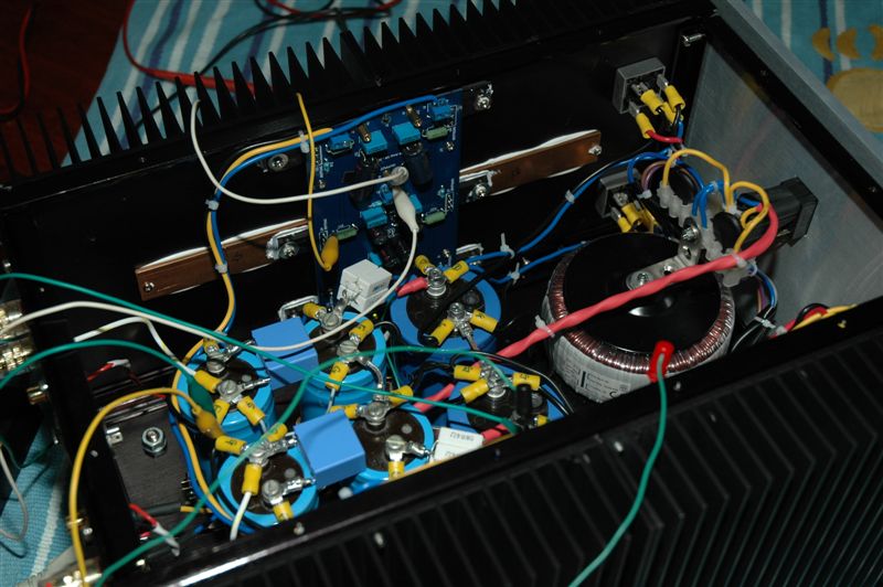

spencer said:F4 going to finish and now under bias adjust.....
Good to see another F4 coming to life...very nice work Spencer
Those PCB are from PD?
Lets hear your first impressions of sound
