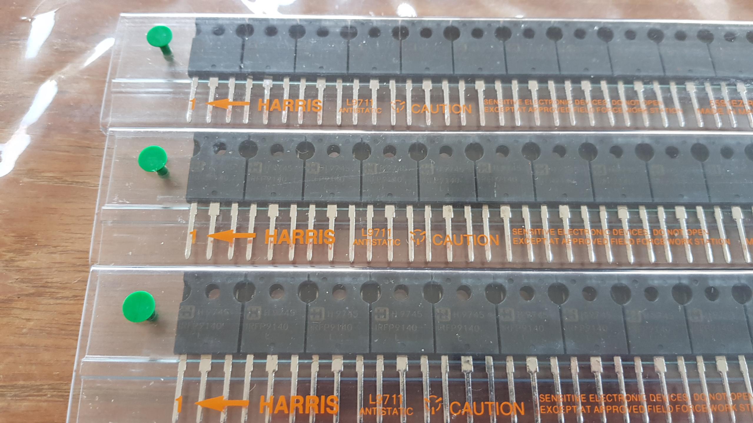

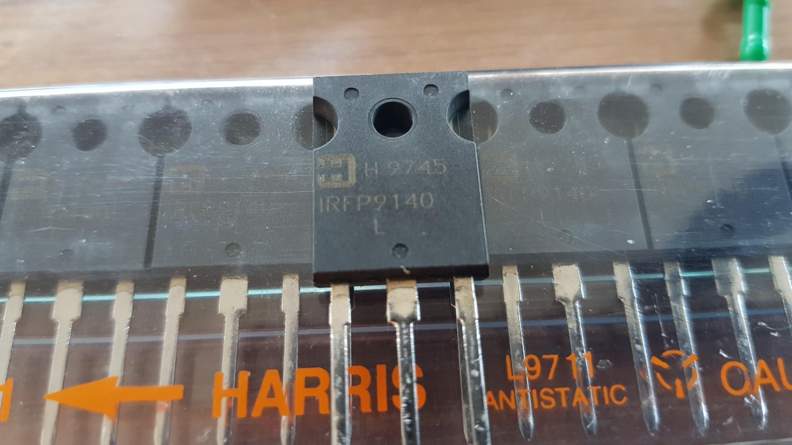

Due to a miscommunication, I have 6 matched Harris 9240s left (two matched trios). Anyone want them?

It is next on my "to build" list and thanks to @cal3713 I have a set of matched Harris 9240 mosfets..dB
