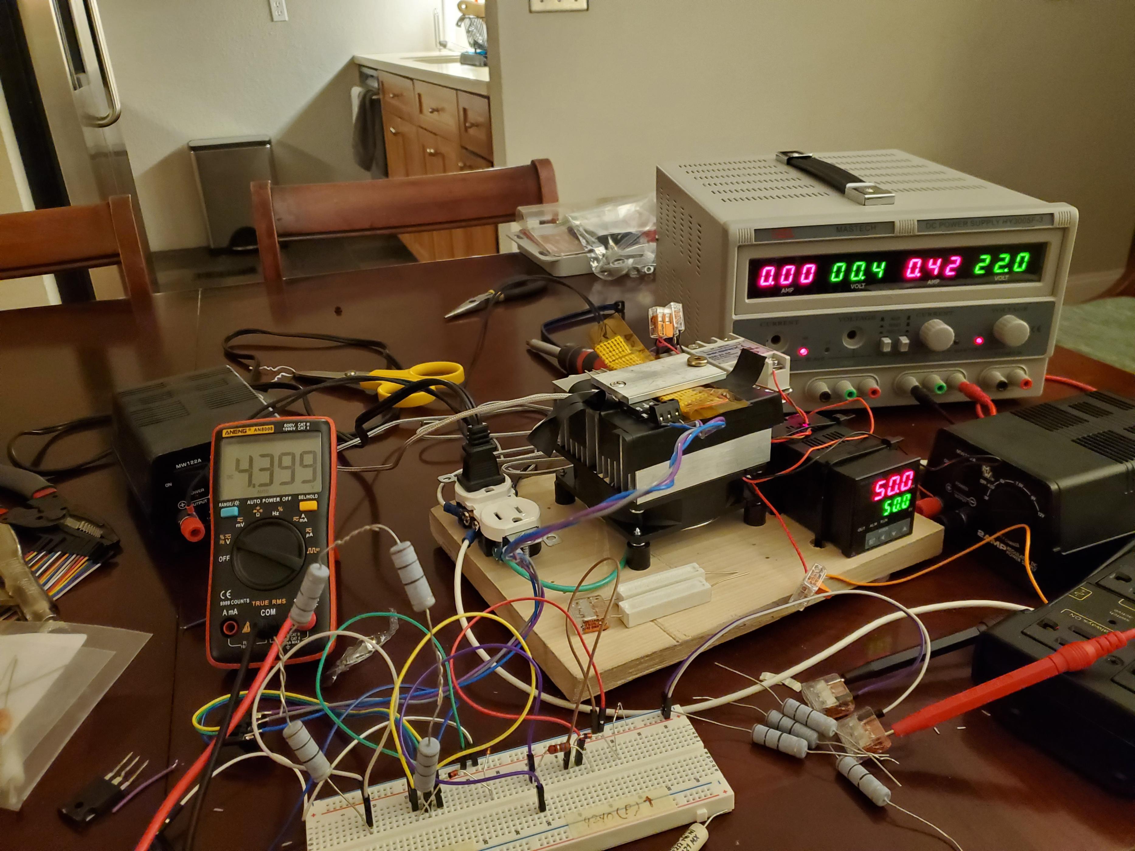

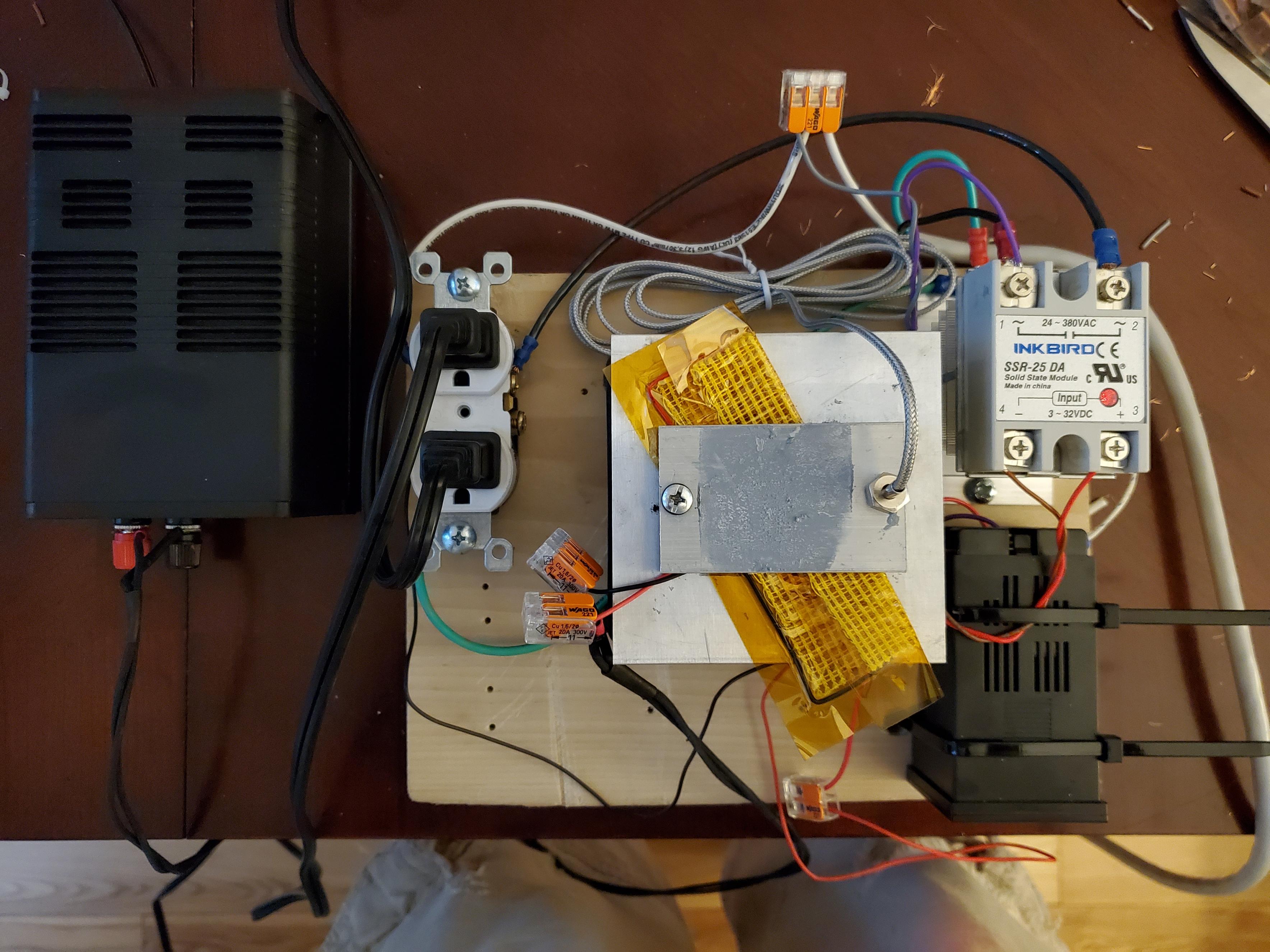

And I've got my testing rig built, still waiting on the reusable zipties for clamping/unclamping, and my regulated lab power supply for providing constant voltage & amps, but am otherwise pretty much ready to go...

8.8W demands some cooling
easiest way is to have moderate sized heatsink, breezed with 12V fan all the time , so temp change would not mean much
clamp mosfet on heatsink, wait while reading became steady and that's it
that's - at least in my book , enough of temp. repeatability
Not super critical, if you're close to operating conditions and they are all done in the same manner this will suffice.
If you have already tested a stack and don't want to have to start all over again, just stick with what you have, just record the testing conditions, so 12 months later you can be sure how they were tested.
It's up to you to decide.

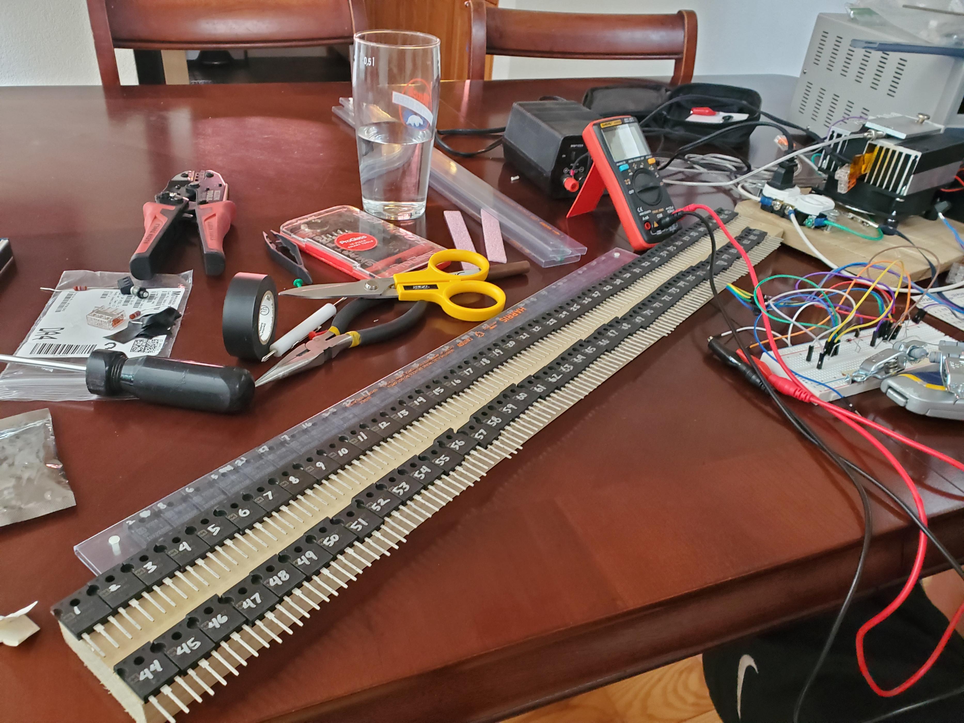

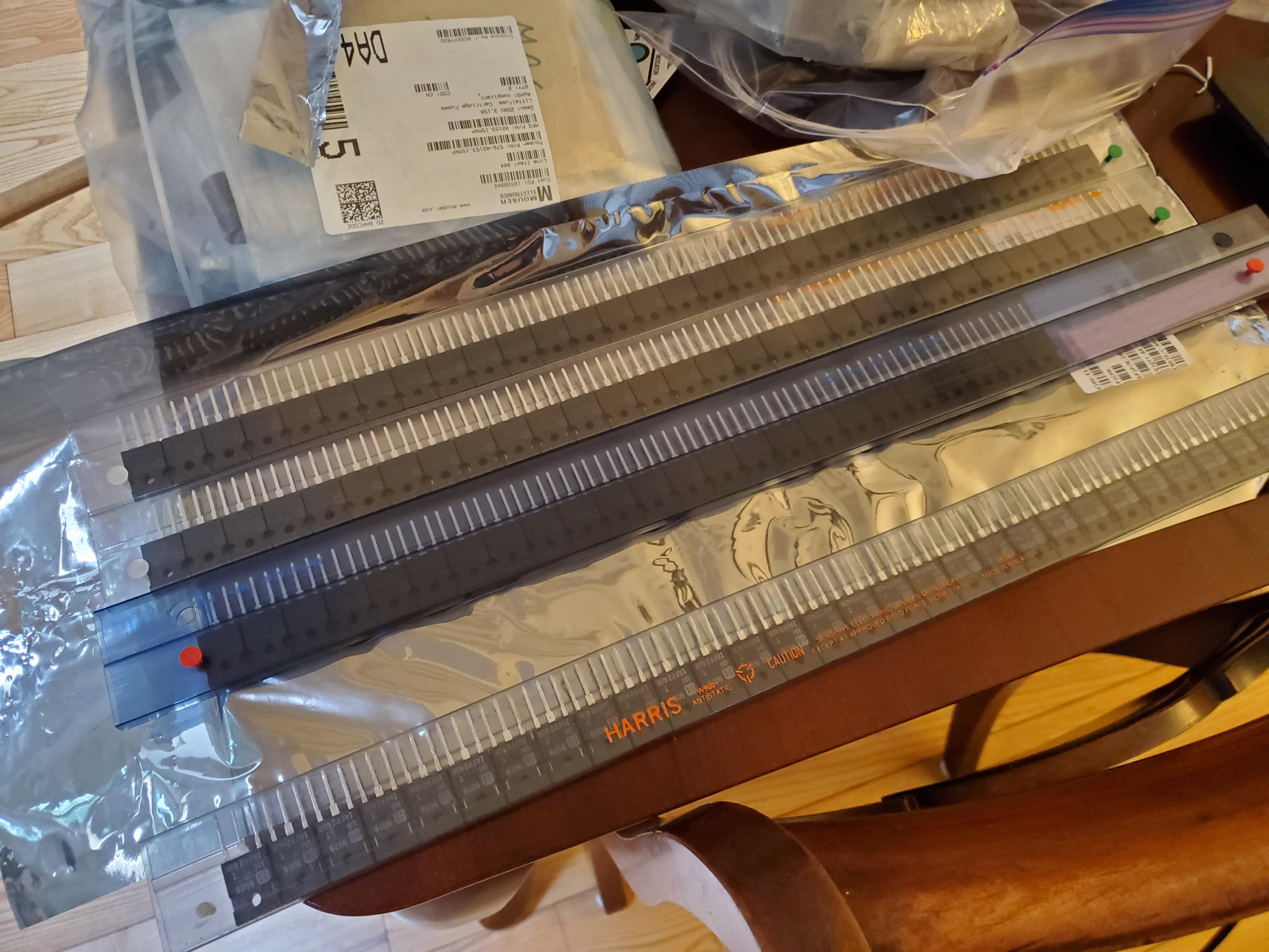

Due to a miscommunication, I have 6 matched Harris 9240s left (two matched trios). Anyone want them?
Hi all. As those of you following the "F4 Power Amplifier" thread will know, Nelson recommends Harris IRFP9240 parts for the P-channel mosfets as they show reduced distortion compared to the 9240s from other manufacturers (see:
https://www.diyaudio.com/forums/pass-labs/97540-f4-power-amplifier-463.html#post6311086). Based on this recommendation, I purchased and matched some Harris parts for a new premium build of the F4.
Due to a large minimum order quantity at Rochester Electronics, I currently have 34 extra if anyone would like a matched set (50 currently under reservation). If so, please PM me. They have been matched at a constant temperature of 50C and at the F4 operating characteristics of 22V and .42A. I'm selling at cost which is around $3 per mosfet + shipping.
Pictures of the testing rig below.
