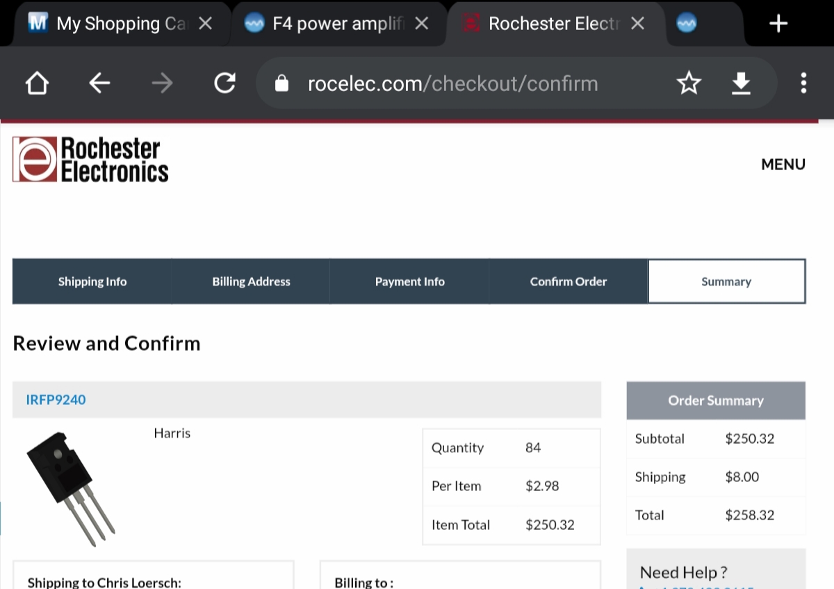

Ok, I did it. Thanks for the suggestion Nelson and the push Jim. I guess I will have to learn something new while making a new set of premium f4 boards after all. Also picked up a tube of 30 Harris irf240Rs off of eBay: New IRFP240R Tube Of 30 Pieces | eBay
I didn't want to mention it so as not to get accused of wasting money, but I'm also using premium resistors throughout the build.
After trying a variety of amplifiers over the past two years (Lyngdorf tdai-3400, Coincident Frankenstein 300b monos, atma-sphere M60 monoblocks, Pass xa-25, & ZM sissy-sit), I've found the F4s to be the best match to my system (A WIP System: Work In Progress (Denver, CO) - Virtual Systems). A month ago I built upgraded power supplies in their own chassis to great effect and now am doing the premium boards with naked z-foils in the signal path. I was looking forward to some A/B testing to see if they mattered, but I guess the mosfet change will ruin that comparison. Gonna quit thinking about amplifiers after that and see if I can build a DHT preamp to try out.
If anyone wants some matched Harris 9240s, let me know. I'll have 72 extra. I start a new job/career in another month or so and thought this would be a fun way to end unemployed quarantine.
Such a good group over here, thanks for all the help. I'm sure I'll be asking for more.
I just purchased some Harris IRFP9140
Hah! Good for you. I've got an F4 ready to go into the chassis, but Nelson's Harris reference go me fired up, too. I'd be thrilled to take some matched pieces of your pie, and then not be kicking my own self for not plunging into the project by buying 84 of 'em.
Great. I've got two on the list. Can you send me a pm with desired quantity just so that I don't lose track?
Also, since I am in the enviable position of being unemployed, but with a full salary coming shortly, I went ahead and purchased a fully regulated lab bench supply and am getting a pid controller with heating and cooling elements so I can test the 9240s at 22v, .4a, & at operating temperature.. just like they'll be run in the f4. In for a penny, in for a pound (and recently single and incredibly bored).
