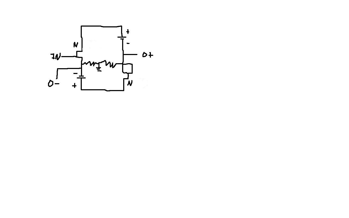

iquam,
power supply complication... multiple supply but same power draw as f4.
drive circuitry...maybe a transformer like f6 or something...? i had the idea of simply driving it with the D1.nice for low wattage speakers.

Transformer coupling with +/-20V swings is probably not a good idea. I could be wrong, but none of the line transformers are suitable for that.iquam,

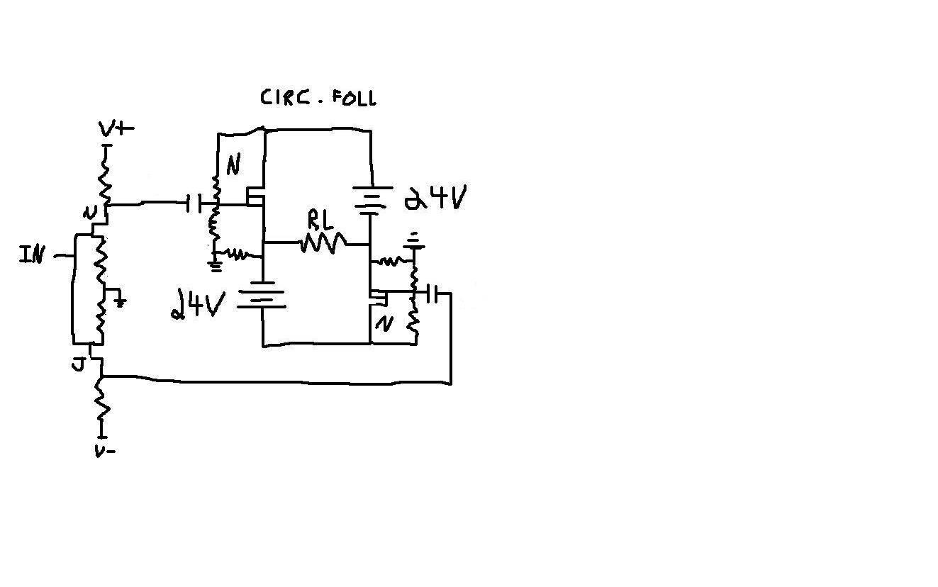

without stepping in Pa's IP barbwired yard , I can say - look in thread called something as Magma front end for F4
I think few capable xformers are mentioned there
though , not that xformers are sole way to feed da circlotron
issue beaten to death by toob guys , Atmasphere and such
all one need is phase splitter with some cojones

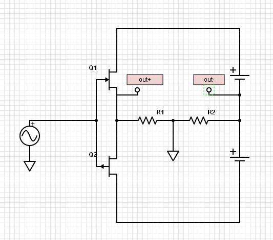

No, it won't work.
The circuit you drew produces signals that are in phase one with another.
To drive the circlotron you need signals out of phase (180 degrees one from another).
pidesd,
Still no cigar, that won't work (it's no shortcut to symmetrical excitation).
And outputs need reference to GND too.
BTW, for yours and ours sake please use at least this: Invalid Request

if the goal is to have minimum even harmonics at the speaker,would it make sense to use a line level splitter like attatched, with low even harmonics numbers, and then feed it to a complete symetric path to the speaker(for example, balanced bride of zen+circlotron follower) ?
as opposed to say, feed a line level signal to a scaled down son of zen with one input grounded,or an opamp-splitter (like juma did), to generate a balanced signal?
