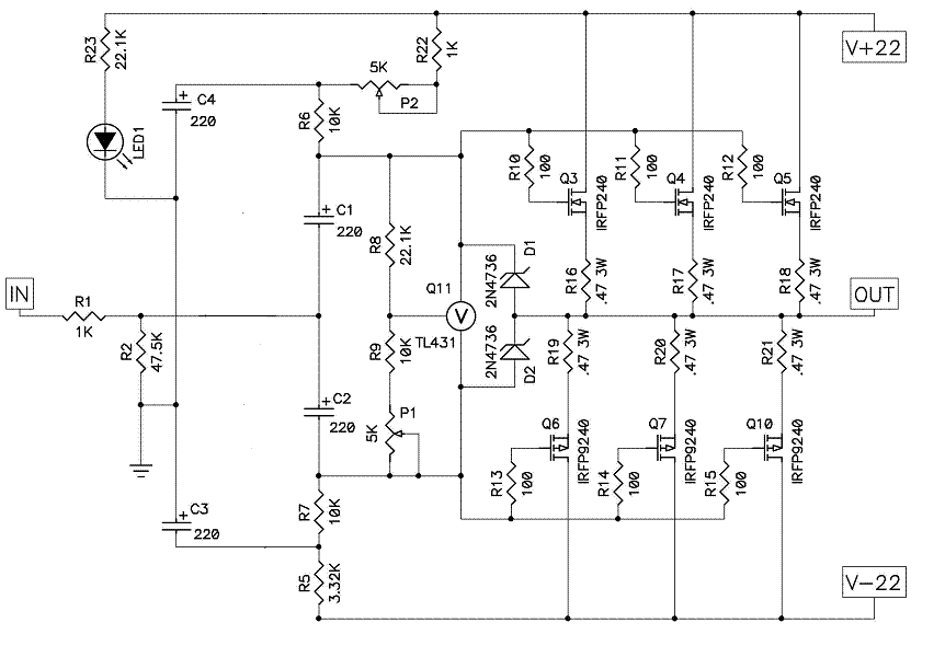

You are changing the resistors the wrong way - use 5K pot (P1) and 5K resistor (R9).
EDIT - 0.8V measures across source resistors is 1.7A -- that's a lot of bias current!! What are you trying to set? 0.3V is ideal.
R9 at 5k and pot at ten K will give a very wide range hotter than 6L6 would call for ( more current) . More current produces much more heat and lower distortion so it is a trade off. 6L6 is correct start at .3 V and work your way hotter SLOWLY . 1.7a is a lot of heat needing larger heat sinks. The life of this with more than 1 amp can be called into question . Thanks for the graphs on a real unit. Very interesting the upper harmonic at 1watt stay flat at 50 volts very nice work.You are changing the resistors the wrong way - use 5K pot (P1) and 5K resistor (R9).
I did... but the bias is getting higher (1.XX V)....
Yes... I know 0.8V is too big...
1st change is parallelling 10K (to get 5K) on R9... Unfortunately bias is getting higher... After putting in series with 22K, I started to get a lower Bias... I'm settled on 22K and 10K. With those value I can set the bias around 0.2V...
But the question remains : Is it OK for me to use R9-22K and P1-10K..??? Or is there anything i should check...?? so far the heat is OK but still monitoring its stability

The question: Am I right that to disable the input buffer in a standard F-4 I have to remove q1, Q2, R3 and R4, and short gate to drain in both channels ?

ZM - thanks for the schematic - the picture is worth a1000+ words 😉

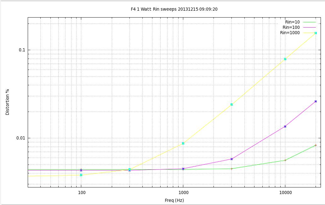

I am not sure that the 1K resistor R1 wants to be in series with the input. With the high MOSFET Ciss capacitances, R1 will roll off the high frequency response. Simulations show the following THD behavior with R1=10R, 100R, and 1K.
Here is a minimal crippling of the F4. I have been using this for many months and it measures and listens fine. The simulations are also fine. The advantage of this version is that you can add a 3-pin header which provides either the In2 connection for the crippled F4, or a jumper for the uncrippled F4.
The 1K input resistor is to act as a gatestopper on the input Jfet buffer, to keep high-freq oscillation at bay.
As the input buffer isn't used on a crippled F4, it's not strictly necessary. The Mosfets have thier own gatestopper resistors.

mea culpa ; didn't checked pic I posted - just saw title of it (F4 crippled) prior to attaching it
that resistor need to be either zero or bridge or tiniest one , just as lhquam wrote
Looking closer at the F4 liberated schematic I notice that we have 2 large electrolytics directly in the signal input.
That is a good thing because they block any DC from the preamp and that the preamp then does not need to have an output cap ?, and it is a bad thing because electrolytics tends to add to the sound, sometimes more when they are biased.
Is it wortwhile to bypass C1 and C2 with film caps ?
