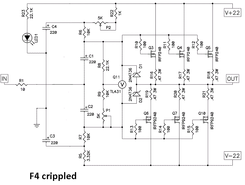

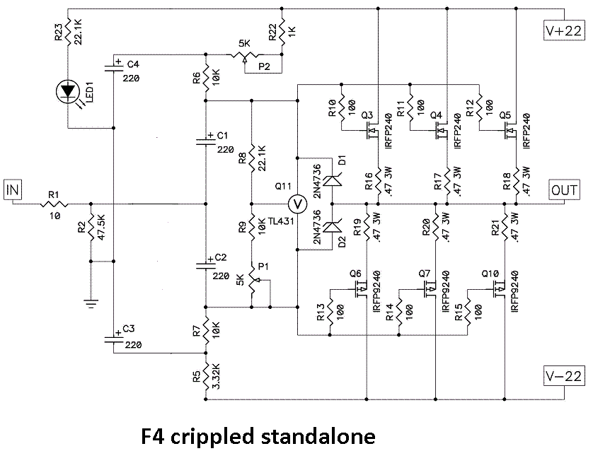

So to catch up on this, it looks like with the crippled version we would be trading the jfet front end for electrolytic coupling caps. It's not obvious to me that this would be a win, sonically. Am I missing something? Other than an easy way to allow increasing the PS rails.

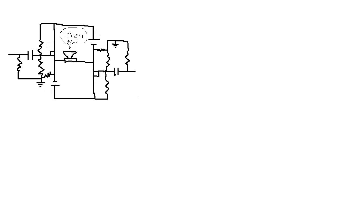

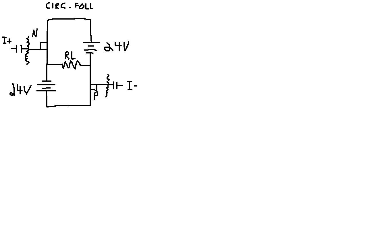

Yes, The Circlotron. There was a P device where ther should have been an N 😀
We overlooked that because we thought we knew what you meant 😉
There are not enough circlotrons in the world, believe it or not

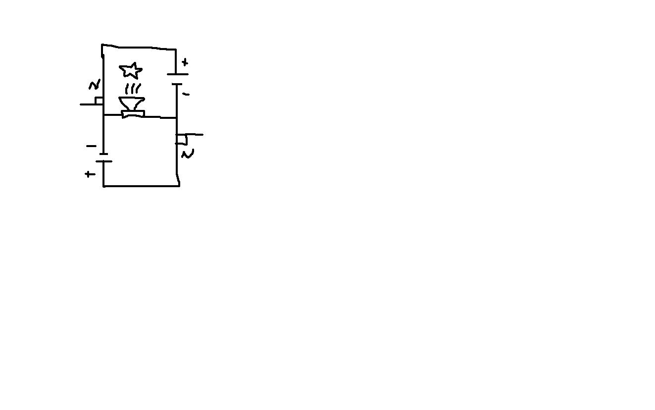

Looks like a good idea, but how do you drive the gates? Most of the complications will be to obtain the necessary gate voltage swings and bias currents for the output FETs.i meant in post 3906:
...there must be some way?
There are many ways - here are the two complete circlotron projects:

Advantages:
- The drive circuits have 1/2 the capacitance to drive vs. the push-pull F4.
- Excellent H2 cancellation
- Power supply complications.
- Twice the gate drive circuitry, unless someone comes up with a very clever design.
replace voltage with CCS-es , drive them as M2 is driven , use matched mosfets , use servo for one CCS if you're hysteric
anyhow - are sources on proper side ?
polarity (N) is OK < if that's what's meant , but symbols are flipped
